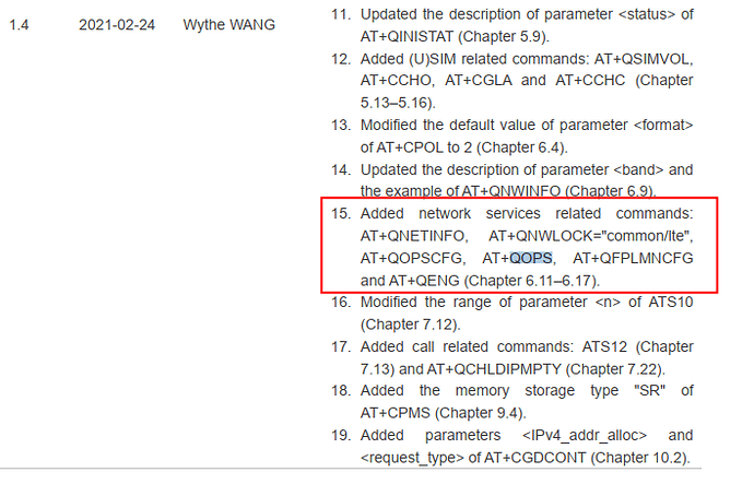

I have noticed the change record of AT instruction. This instruction is supported in the change of 2021-02-24. Could you please tell me your modem version? The version information is the Modem name on the home page.
