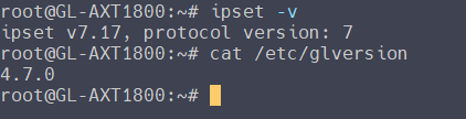

The AXT1800 with the v4.7.0 looks like no issue.
I will ask my colleagues to check if this issue is wrong or not.
Hello Bruce,
You are right, the behavior of ipset has changed and now the latest one, coming with v.4.7 firmware, works correctly. The problem is BanIP is not available for v.4.7 and many users (I am one of them) will continue using older (because it is very stable) firmware.
All in all, this is not a drama, just saying.
