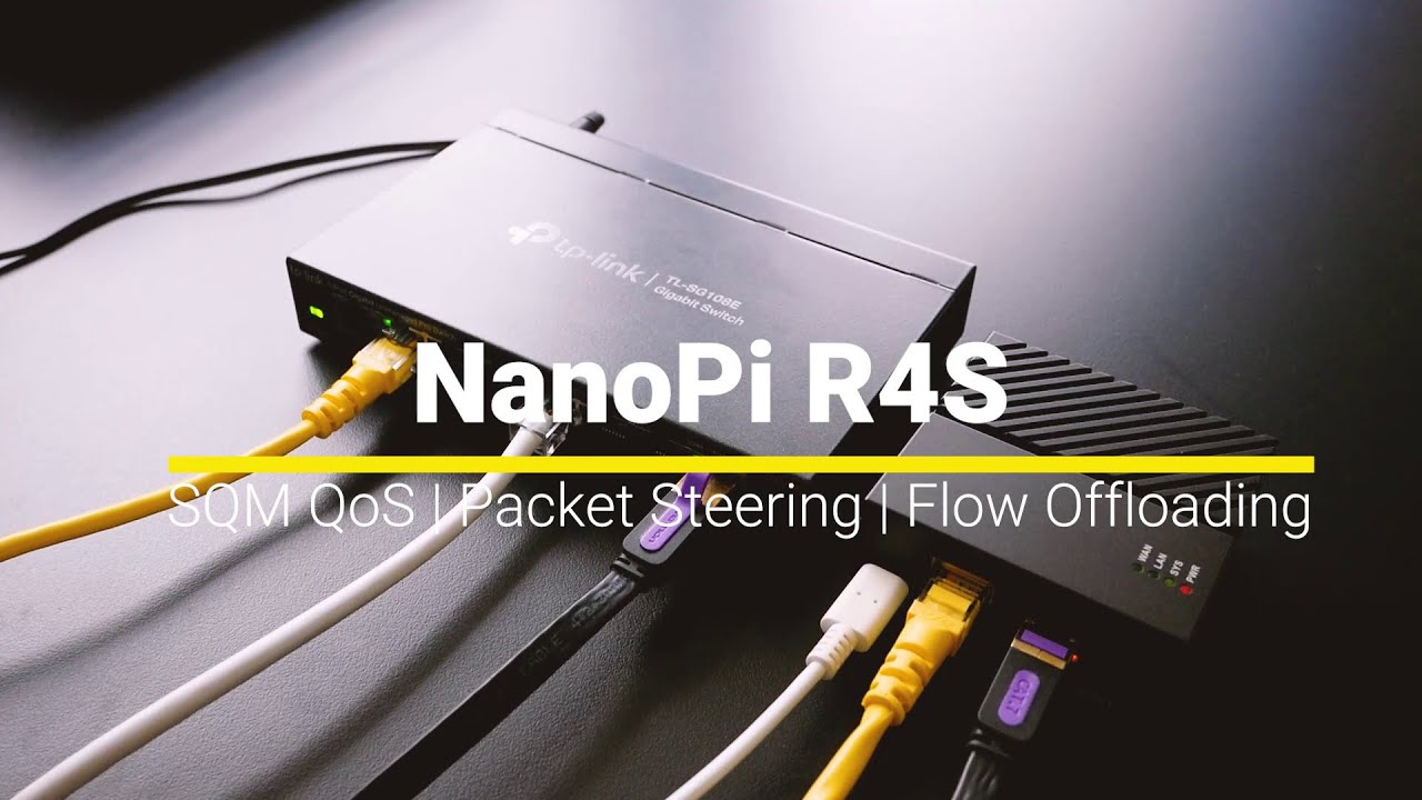

If you don’t need AP I’d be looking @ Friendly Elec’s NanoPi R4S. Van Tech Corner is ‘the man’ to see here:
