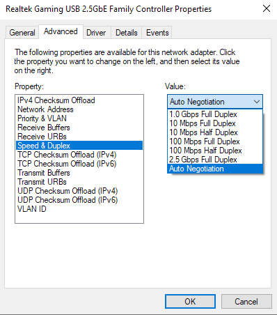

NIC
Ethernet controller: Realtek Semiconductor Co., Ltd. RTL8125 2.5GbE Controller (rev 05)
Please try to lock the negotiation rate "2.5Gbps" in your computer's NIC network card settings
