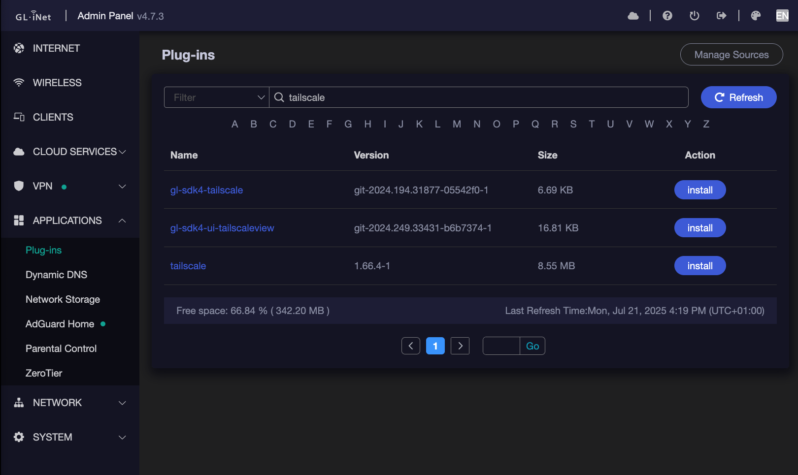

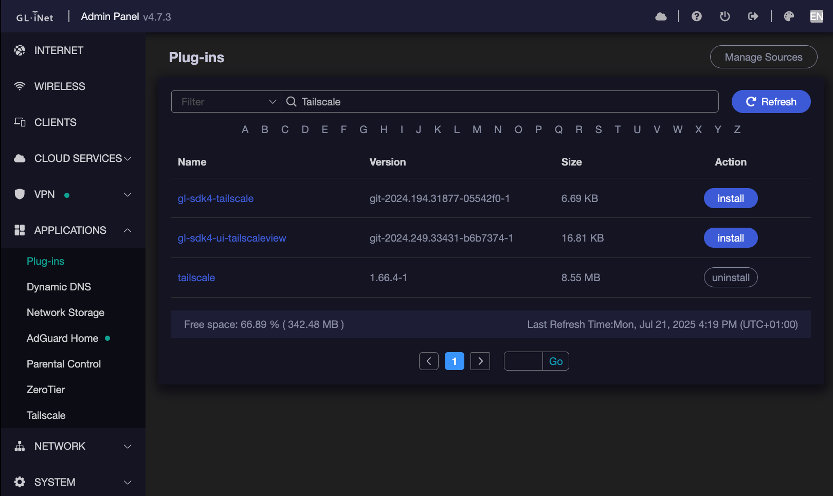

The BE3600 comes with a number of third-party packages pre-installed. Some of these I will never use as I have no use for them, and so I'd like to remove them from both the device and the UI. I just like a tidy working environment :slight_smile:

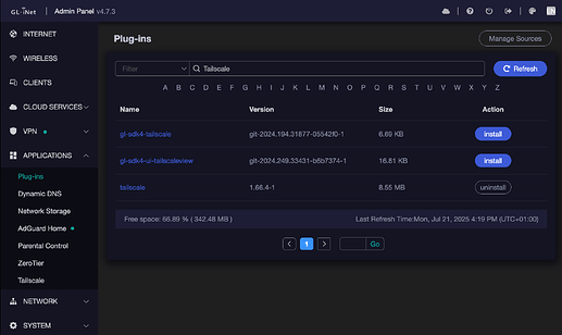

I notice from Applications->Plug-ins that Tailscale (for example) is installed and is presented with an "uninstall" button:

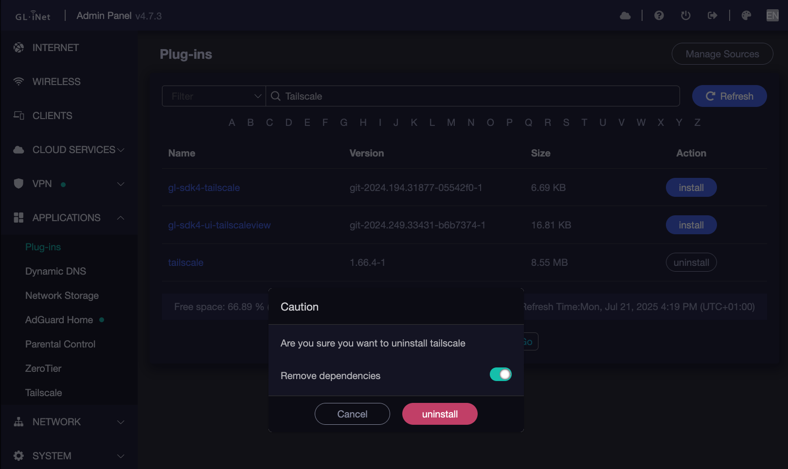

Clicking the uninstall button results in a modal window that prompts if the process should remove dependencies:

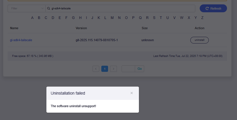

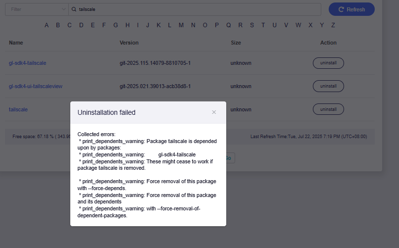

Clicking the very inviting "uninstall" button results in the following failure message:
Collected errors:
  • print_dependents_warning: Package tailscale is depended upon by packages:
  • print_dependents_warning: gl-sdk4-tailscale
  • print_dependents_warning: These might cease to work if package tailscale is removed.
  • print_dependents_warning: Force removal of this package with --force-depends.
  • print_dependents_warning: Force removal of this package and its dependents
  • print_dependents_warning: with --force-removal-of-dependent-packages.
Clicking on the "tailscale" link back on the Plug-ins, confirming the removal of dependencies and clicking on the uninstall button results in the same error above.

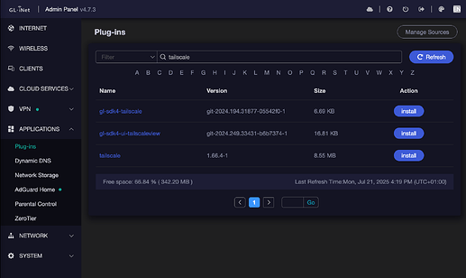

Obviously, logging into the device as root, identifying the packages, then removing them and finally restarting the UI results in the package removal from the UI:
root@GL-BE3600:~# opkg list-installed | grep -Ei 'tailscale'
gl-sdk4-tailscale - git-2025.115.14079-8810705-1
gl-sdk4-ui-tailscaleview - git-2025.021.39013-acb38d8-1
tailscale - 1.66.4-1
root@GL-BE3600:~# opkg remove --autoremove \
> gl-sdk4-tailscale \
> gl-sdk4-ui-tailscaleview \
> tailscale
Removing package gl-sdk4-tailscale from root...
coreutils-timeout was autoinstalled and is now orphaned, removing.
Removing package coreutils-timeout from root...
coreutils was autoinstalled and is now orphaned, removing.
Removing package coreutils from root...
Removing package gl-sdk4-ui-tailscaleview from root...
Removing package tailscale from root...
Updating database.
Database update completed.
root@GL-BE3600:~# /etc/init.d/uhttpd restart
root@GL-BE3600:~#

I used BE3600_V4.7.3 version for local testing and found this problem.
At this point, it is recommended that you uninstall the package via SSH.
