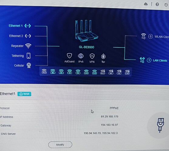

For what concerns ISP params: yes, I have an ONT installed connected to the wan port. My isp gave me these settings:
Username & password
Protocol:PPPOE Routed
Encapsulated VLAN Ethernet 802.1g
Nat Active
VLAN 100
I made a factory reset and configured the access as per ISP params, everything’s ok, both wired and wireless connections do have internet access.

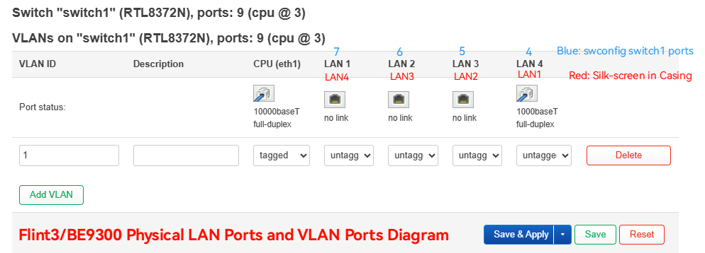

Attached the swconfig port mapping, please check the physical-to-logical port connections against this following diagram:
Both the Flint 3 and Flint 3e are built on the same swconfig framework.
