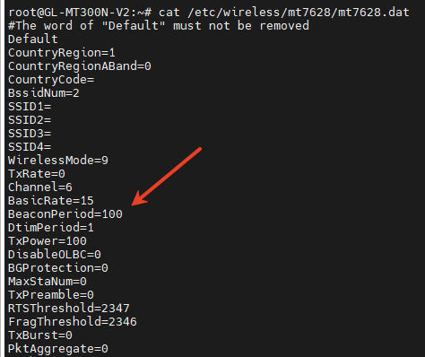

Here can find the beacon interval of 2.4GHz WiFi to configure:
/etc/wireless/mt7628/mt7628.dat
Thank you sir, very helpful.
