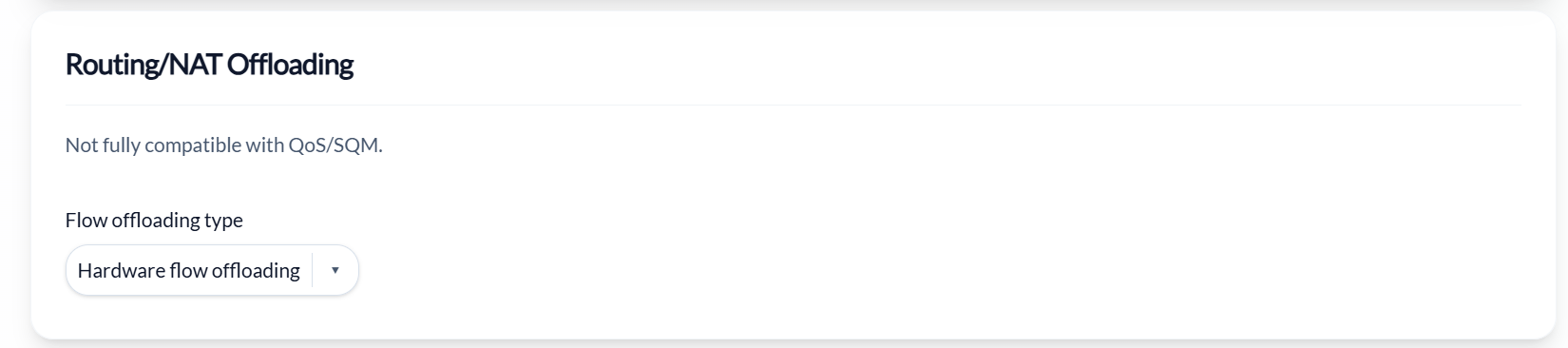

from what I know from this feature in gl ui, is that it is just this in luci under the firewall tab:
^ note I use a custom theme.
But since luci is designed for OpenWrt, and also OpenWrt drivers, the MTK SDK did a poor job of implementing the full luci support, and likely if not all it either doesn't work, or broken.
however when I read responses of GL devs, it gives me the assumption they are not going to fix it which mean this functionality is more of a remnant if not broken, you have likely much more better chance on OP24 builds for this, for QSDK platforms this is kinda the same except you need to disable GL_QOS scripts for NSS offloading to work.
