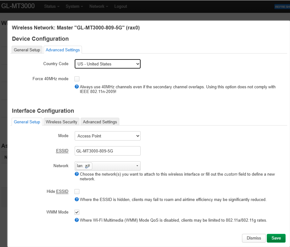

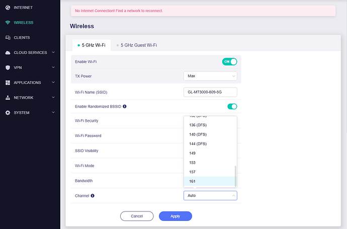

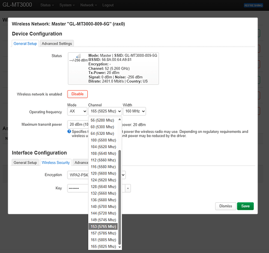

Beryl AX can also support high-frequency 5 GHz signals, for example CH157, CH161.
Please note the Wi‑Fi country code of the Beryl AX — you can change it in LuCI:

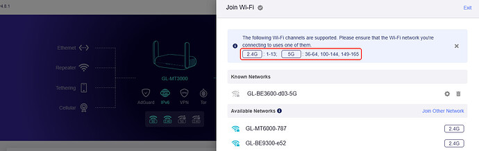

Regarding some questions about the Beryl 7, even if you managed to enable higher 5 GHz channels on the Beryl AX by changing the regulatory domain.

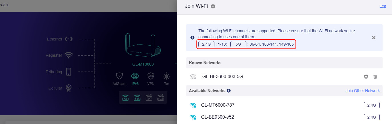

The Beryl 7 supports the same 5 GHz ranges as the Beryl AX: CH36–64, CH100–144, and CH149–165, higher channels are not supported.
The Beryl 7 also has one single 5 GHz radio, so the AP channel is always tied to the source channel of repeater.
