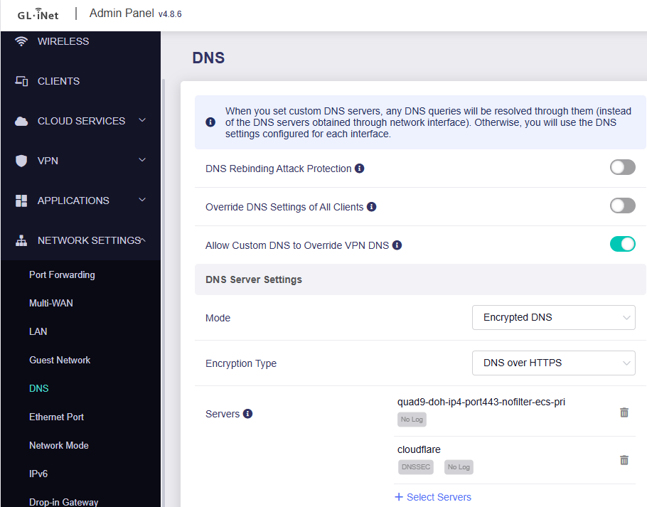

Upgraded to 4.8.6 to see if stability is improved. Initial feedback is encrypted DNS was broken after the upgrade. This has been disabled to focus on stability testing (judging from the other threads the encrypted DNS issues are well known already from other devices)

After upgrading clients behind the device as well as the device itself could not resolved DNS. Settings were DNS over HTTPs using Quad9 ipv4 no filter ECS and Cloudflare. Changing to ‘automatic’ for DNS resolved the issue. I have not yet tried re-enabling Encrypted DNS to see if the issue comes back.

As a side issue with this 4.8.6 beta as mentioned earlier, re-enabling Encrypted DNS (DoH) breaks connectivity again so I have left it disabled for now.

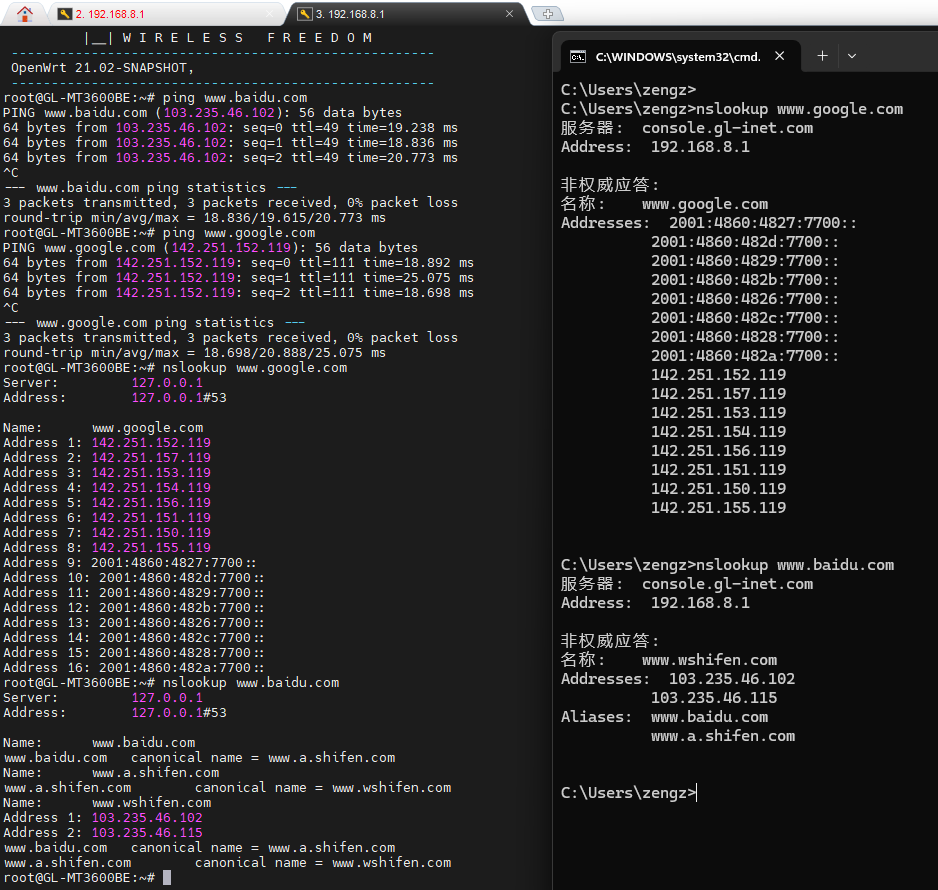

Is this your setting?
I upgraded my router to firmware 4.8.6 without retaining any configuration settings, only connecting it to the Ethernet WAN port.
Then I configured the DNS, but it seems that both my router and client DNS resolution are working correctly.
We're unsure if there are any other contributing factors. You can test to see if you can reproduce the problem.
If you have logs or more configuration information that can reproduce the problem, please send them to us for review.
Thank you.

@lucas2 Switched to 4.8.6 stable and cant reproduce DNSoHTTPS issues now.
