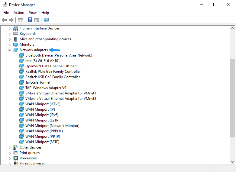

First of all, please let me know if it works with PC?
please screenshot the network adapter of the device manager when the mifi connected the PC.
