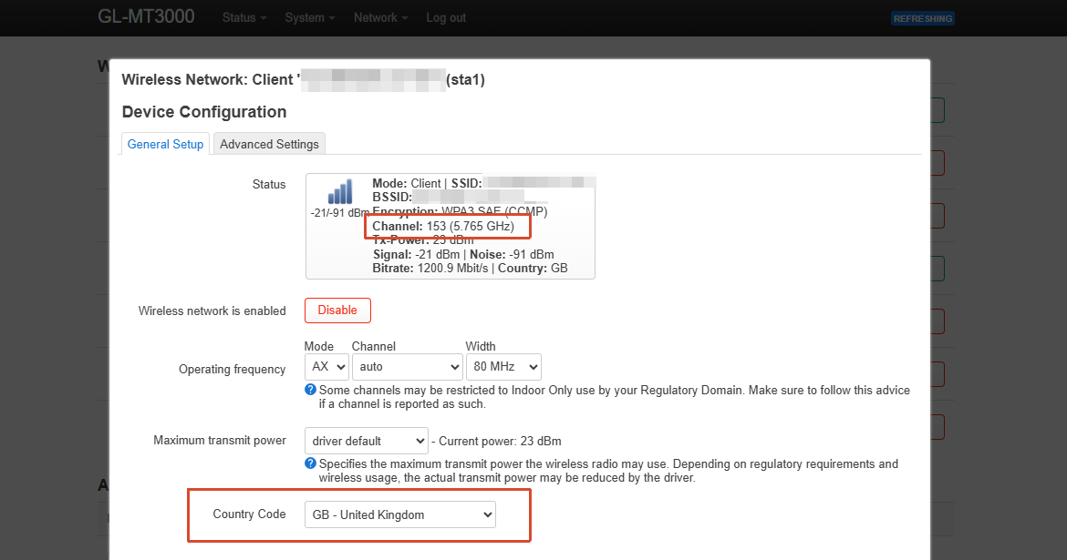

Check luci for what your country code for that particular radio actually is. Change it to UK-GB if not done.
I did. I set it to GB. Still did not show up.
Please try using the op24 firmware instead.
We tested it locally and were able to connect to an upstream Wi-Fi network on channel 153 while using the UK country code.
