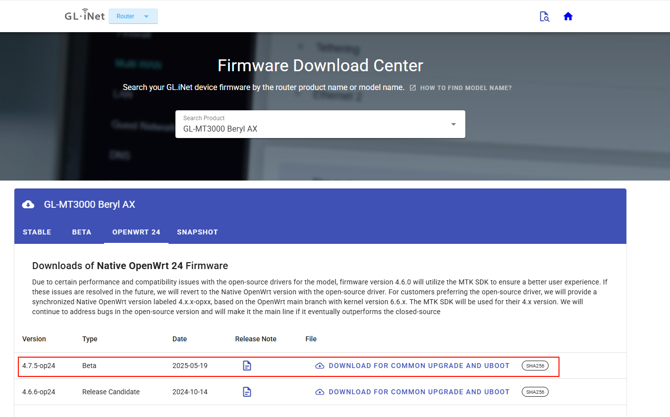

Please try installing the op24-4.7.5 firmware: GL.iNet download center

It seems no issues on this firmware. But there is no GL panel and critical features like BSSID randomization or VPN support, so I am not okay to stay with it.

There is GL GUI in op24-4.7.5 firmware, and also BSSID and VPN features.

But why I can only see LuCi on this firmware?
Can you provide screenshot?
Via LuCi it is connected as repeater fine on op24-4.7.5.

UPD: Flashing op24-4.7.5 firmware helped.
Issue disappeared. Seems to be an issue with main firmware line. I will stay on op24-4.7.5 firmware.
