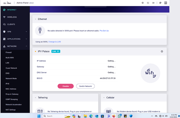

Beryl AX (MT 3000) won't connect to as repeater in Malaga Spain
Just arrived in Spain excited to give the product a go. Now 4 hours later… and reading countless reviews on the topic. Has anyone come closer to arriving at a real solution, vs workarounds like tethering a phone connection?
I saw a link about a wifi driver also, but have no idea if there is a special place on the router to load that new driver/firmware.
This has proven quite frustrating and hopefully the community has found a real answer.
Many thanks in advance.
Screenshot 2024-02-22 213548

  • Haven’t changed DNS settings (not even getting an IP address to begin with, so not sure how that would help at that stage.
  • Tried both factory and random. No difference as it just stays stuck trying to get an address as shown in 2nd screen shot.

Don’t think static IP will work if it won’t resolve any IP at all (nor gateway/DNS) per the first screen shot. The captive portal network security is Open. But here I’ve uploaded the security settings. The only thing I’m less familiar with is the impact DFS will have on things and if there are any special adjustments to be made as a result. Please see original screen shots uploaded. Hopefully this helps someone diagnose. Let me know if you need anything else.
