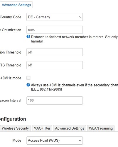

I have 2 Beryl AX and 1 Slate 7 (and just ordered the Beryl 7 :grin: ) and both don’t have channel 138 (132, 136, 140, 144).
It makes no difference if in repeater or AP mode.

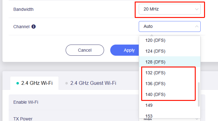

In the Wireless page of the GL UI, we only display the channels that are available under the currently selected channel width.
In the DE region, channel 144 is currently unavailable due to regulatory restrictions (limited to short-range devices with a 25 mW power limit).
As a result:
  • With 40 MHz, channel 140 is not selectable
  • With 80 MHz, channels 132–140 are not selectable
  • With 160 MHz, channels 132–144 are not available due to regulations
You can select a 20 MHz channel width to display all available channels.
Alternatively, you can check the channel information under Internet → Repeater.

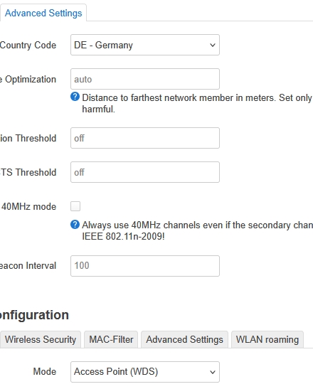

When did this change?
Everywhere its written that UNII-2 Extended (5470 - 5725) is indoor/outdoor with DFS is with TPC 30 dBm (1000 mW) and without TBC 27 dBm (500 mW).
Sorry, I can just post one link.
Well, I think the link you provided already clarify this clearly?
The frequency range of channel 144 is 5710–5730 MHz, which slightly exceeds the permitted range (5470–5725 MHz).
From Federal Network Agency (bundesnetzagentur):
