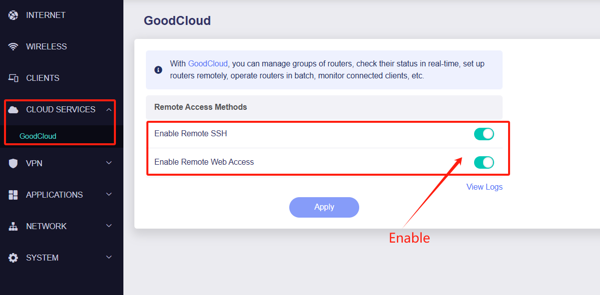

Hi there,
Please make sure enable Remote SSH and Enable Remote Web Access at router's admin pannel first

Thanks Elen - Yes, both Remote SSH and Remote Web access are enabled.
