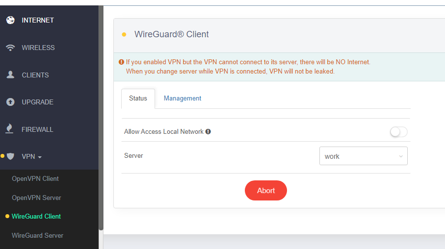

I have 2 beryls and not tech savvy at all. My goal was to have my IP address always show up and connect no matter where I am. I setup one beryl attached to our house router as a server with wireguard. The other I’m trying to setup as a client for when I travel. I added the server beryl config info into my client beryl, but the client beryl shows yellow status and no internet. I had my friend check that the server side at the house side is green. I followed the instructions and read posts, but I am far from tech savvy. I changed the lan IP for the client beryl as I read that was needed in order to connect two routers. I have a public static IP. When I connect to client beryl there’s internet until I click connect under wireguard client then internet drops and it’s status bubble is yellow. I know they include the message that there won’t be internet if VPN can’t connect to server, but I don’t know why it’s not connecting. I keep reading old, but similar posts where the person just ends up private messaging so there’s no solution listed. Any help is greatly appreciated.

Thanks for replying.
Port forward is setup correctly in your main (home) router (not in the beryl!) —Yes port forwarding through the main home router (not the beryl server) is setup. There’s nothing port forwarding wise that I setup on the beryl server. I had my friend check again to be sure that home router is setup though. Can my internet provider be messing with it?
That both beryl + your home router use different subnets. – i changed only the lan IP of one of the beryls (client wireguard beryl). Instead of starting with 192. I changed to 10. as it stated was acceptable. I’m currently at a different location to get this setup and tested to simulate being away. Subnet mask seems to be the same, but I don’t see where to alter those.
Logs? I’d be happy to oblige if you can tell me which logs. If I go into luci i see system logs and kernel logs. If those aren’t the correct ones you are referring to then I’d appreciate guidance to retrieve what it is you need.
Please also post your WireGuard client config file as preformated text, with the keys and personal info redacted. Personally, I would stick to 192.168.xxx.0/24 subnets where xxx is different for client and server (e.g., 18 for client and 8 for server).

So this is what the config from server beryl that i input for client beryl:
[Interface]
Address = My IP (home router IP)
ListenPort = 28079
PrivateKey = redacted
DNS = 64.6.64.6
[Peer]
AllowedIPs = 0.0.0.0/0,::/0
Endpoint = redacted (home router IP port combo)
PersistentKeepalive = 25
PublicKey = redacted
here is the luci system log from my client beryl. It says it’s too long so I guess I’ll break it into multiple posts:

ok that’s everything since yesterday…lots of trial and error. i should also mention that i did try to setup it all at home first before realizing i needed to take the client elsewhere so i am now away in a different location for testing purposes. ![]()
I see the WireGuard client starting and stopping in your system log, but do not see why it stops.
I suggest you first test the WireGuard client config file by running it with a WireGuard client app on a smartphone over LTE. This will confirm whether the WireGuard server and config file work properly and you should not have to move to another house for testing.
For testing in the same house, you should be able to tether the client Beryl to a LTE smartphone over wifi hotspot or USB connection.
Ok i hope I’m doing what you asked correctly. I do stop it right away when I see the yellow so I can get internet back to keep researching what is wrong.
As for the test, I’m not sure I understood. If I just type in the portal address without being connected to its wifi while on my phone then nothing. I can connect to my client beryl wifi from my phone and then i log into the portal and I can see my devices and phone under client section. Then I hit connect for wireguard client that it stops internet. I hope I did it right but if not please let me know.
To clarify testing on a smartphone, I mean to install one of the free WireGuard client apps from Android Play Store or iPhone App Store and load the same WireGuard config file into the client app. Then try connecting the smartphone client app over LTE to the WireGuard server on your second Beryl router. This test does not involve using the WireGuard client on the first Beryl router and only confirms the WireGuard server and config file work properly. The LTE connection will be on a different network like being in another house.
By the way, you can also look into the System Log on the second Beryl with the WireGuard Server.
I appreciate it if you can put the description in paragraphs and add images. It will be much easier to understand.
Looks like my response to you disappeared. First thanks for the extra information. I feel like I’m learning so much. So I did what you said about the app and adding the same configuration file. I connected while on mobile LTE then checked the logs in settings. The log says “peer sending handshake initiation” followed by “handshake did not complete after 5 seconds”. It just keeps saying that.

Basically my goal is two have my two beryls and my home router. one beryl connects to the home router as a wireguard server and the other beryl i take with me on trips. I want my ip address when traveling to show as home.
Right now, my wireguard server beryl shows green but the client beryl shows yellow. I can connect to the client beryl via my devices, but when I hit connect under the wireguard client menu option then internet drop and I have no internet. I know they include the message that there won’t be internet if VPN can’t connect to server, but I don’t know why it’s not connecting.
Not sure what all screenshots you would like.
following wcs2228, wireguard play store app instructions to try connecting over LTE to the server.i saw the log about the handshakes.
Please let me know what other images you need.
