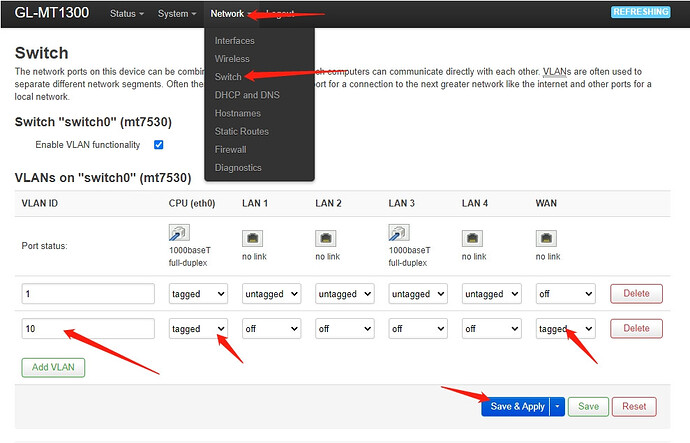

You may have to configure the Beryl WAN to VLAN ID 10.
Just to be clear, I should be able to connect my Beryl (GL-MT1300) directly to a ONT fibre box, using the VLAN tagged to 10, right? (without needing a modem like the spark one?).

Try it this way and see if it works
Unfortunately, that didn’t work as well.

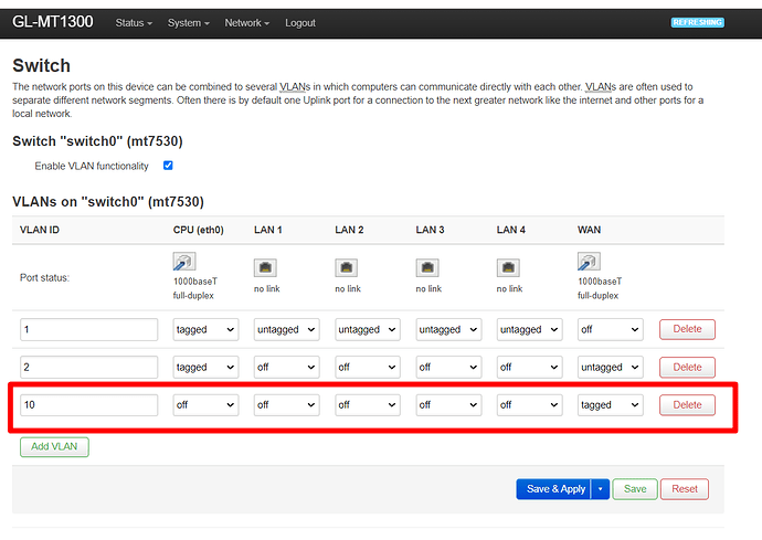

You need to bind eth0.10 to the WAN port
Read this page:
https://chrismolloy.com/p216.php
that’s great! thanks so much @wcs2228 and @dxf, managed to connect using your references.
lucy > network > interfaces > wan > edit > physical settings > eth0.10
for future references, here’s my config:
