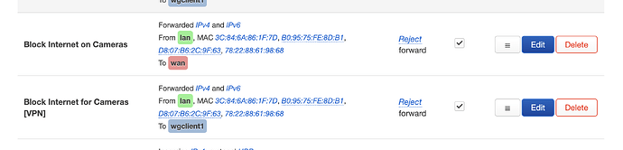

I just updated to the latest software version and came to the surprise that my Firewall rules that block internet access are not working anymore when I connect to a VPN.
If I disconnect the VPN they work again.
I found the issue, the vpn connection name is changed, it was wgclient and after the update it became wgclient1 but the rule still uses wgclient !
After I edit the rule and select the new name everything works again:
In my case this is just due privacy reasons, but I can see that this can be a high security problem for other people. Be safe!
