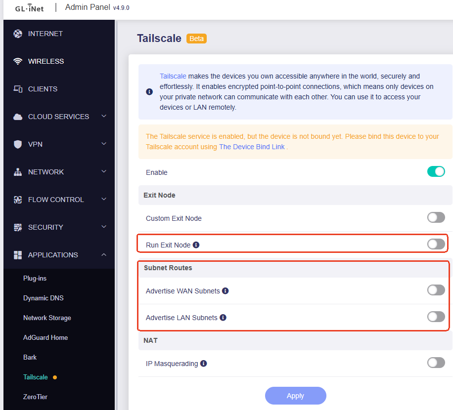

What firmware version are you using?
If you upgrade your router to firmware 4.9, you can simultaneously choose to run Exit Node and Advertise the LAN segment.
Does this meet your needs?
I installed 4.9.0 beta2

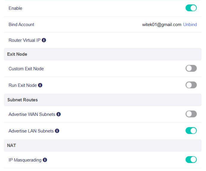

Options are available but with "Advertise LAN subnets" option ON and exit node ON I am unable to access devices in the local subnet (behind the router). I can see the subnet being advertised to Tailscale, it is approved in the Tailscale Admin Console .
With these settings it works fine, I can access devices in router's local subnet (192.168.8.0/24)
with exit node enabled and Advertise LAN subnets enabled I still can’t access router's local subnet
