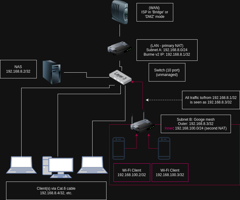

Unless the Google devices can be flipped into a simple AP mode or the client device is already on Network A, usually no. Any traffic from Network B is going be seen as one source based on the MAC of the Google device. One way to theoretically get around that could be to just put every client device on a WG VPN & then use those WG IPs for GL GUI's PBR ('policy based routing') but even if able to be done that's going to considerably impact all client's bandwidth performance (eg: Burme v2: 2.5 Gbps v 355 Mbps). So technically yes but.... you're gonna feel some considerable pain. I wouldn't bother doing it unless you just care about getting < dings > to you phone(s) rather than heavy surfing/streaming.
EDIT: based on your diagram all you'd have to do is drop the 'Google Wi-Fi router' behind the switch provided the overall cable runs aren't an issue:
One thing I might suggest as an experiment is to take your second Beryl AX & flip it into AP mode, downstream from the Burme v2. Flip its TX/RX power output to max & see how its range, quality compares to the Google set up.
To go a step further it's not impossible to build your own mesh network on pure OWRT + approp. harware/antennas but that's all dependent on environmental conditions like the building's construction, overall footage, etc. Then you can sell the Google gear on a second hand market to who just want that 'appliance' approach to networking.
