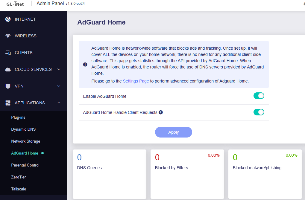

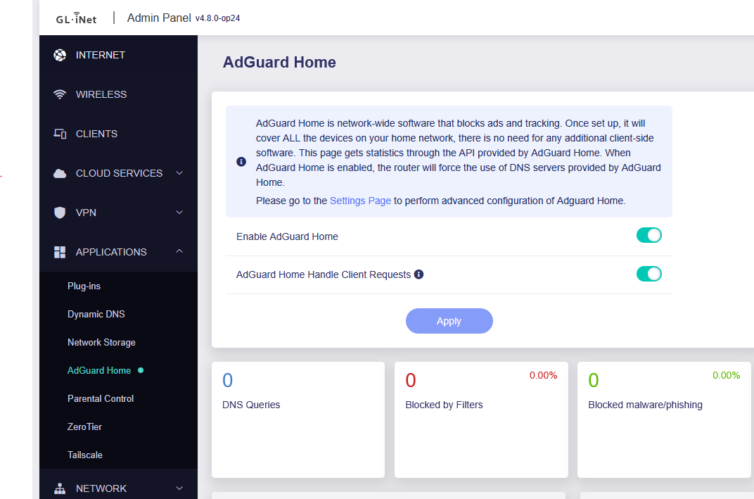

@bruce One bug, that came to my attention: I'm running the latest OP24 with my MT6000 and AdGuardHome (Version: v0.107.64) values are not showing up.

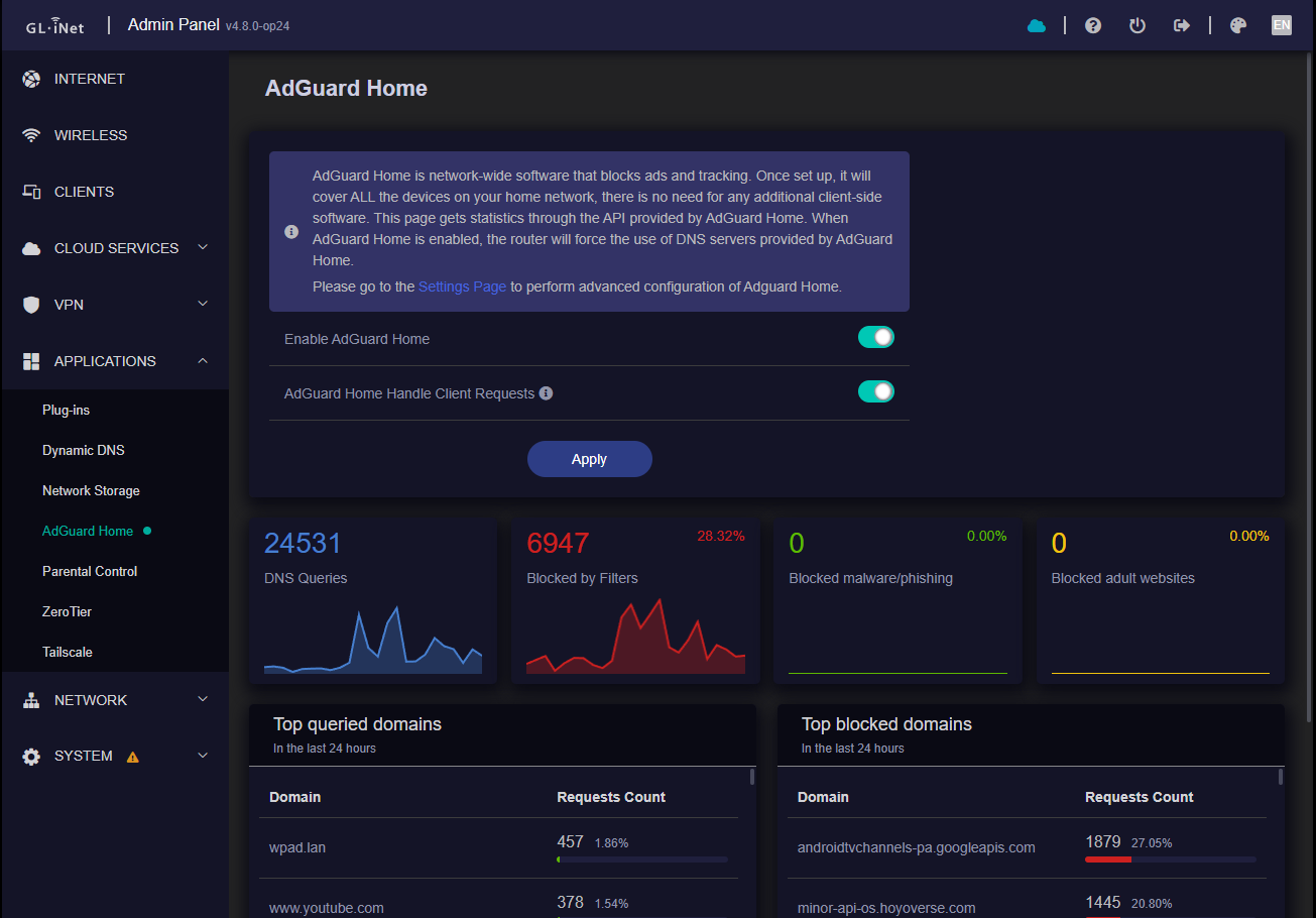

I tested the preinstalled ADG (v0.107.56) in v4.8.0-op24 firmware, and it works ok.
Not sure if the newer version ADG has modified the API, please use the preinstalled ADG version.

Hi @bruce, the same problem exists for the MT-3000 but with AdGuardVersion 0.107.56)
So this workaround is not really a solution. Could you please look into this?
MT6000, Everything works, I did a clean installation.
The MT3000 is currently in another city, but when I arrive, I will check it out.
Which AdGuardHome version are you running?
