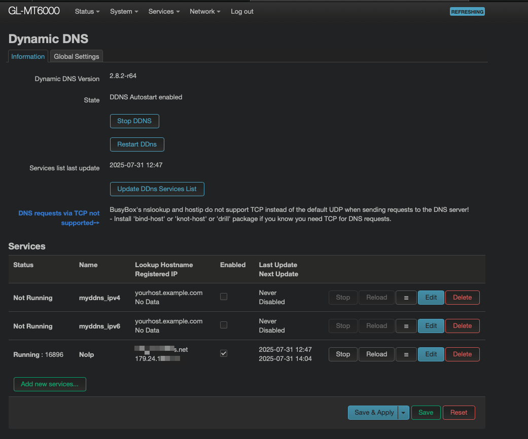

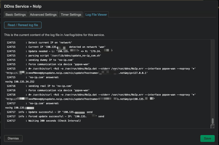

Does the NoIP DDNS still resolve even though the endpoint didn't accept the device side's script push attempt? I've seen other DDNS providers not accept the push as there's been no IP change require updating. drill $myNoIPDDNSHere
opkg update && opkg install drill
The strange thing is that with firmware 4.7.7 it works perfectly. From what I could see in this 4.8 version, No-Ip.com responds with bad authentication. Even though the IP is the same, the script forces NoIp to accept it. If I copy the URL provided in the log and paste it into the browser, the IP update is performed.
How strange. What version is ddns-scripts-noip showing as?
opkg list-installed | grep 'ddns-scripts-noip'
Here, in case you need to downgrade to compare the last 'known good' but want to keep the current state's confs:
opkg update && opkg install openssh-sftp-server
The current version of ddns-scripts-noip that doesn't work is 2.8.2-r64, the last one that works is 2.8.2-12
It sounds like you've identified a problem with the upstream sources. Do you have a diff tool to compare the scripts? If not Beyond Compare is quite good & has a 30 day trial.
Thanks. I have a Beyond Compare 5 license and there are differences in the files dynamic_dns_functions.sh, dynamic_dns_lucihelper.sh, and dynamic_dns_updater.sh, mainly in the functions for obtaining the IP. Firmware 4.7.7 talks about obtaining the local IP, while firmware 4.8.0 talks about obtaining the current IP.
Well, assuming those are baked into the scripts & not configurable options you seem to have discovered a bug between the two ddns-scripts-noip packages.

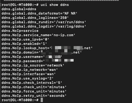

I don't use No-IP but is 2.8.2-r64 set to use ip_source='web' & use_https='1' on interface='wan' on a ip_url?
uci show ddns
I'm running ddns-scripts & ddns-scripts-services v2.8.2-12. My IP updates use ip_source='web' with https, cacert & ip_url. I don't see those lines in your output. You may have to edit/add them to your ddns conf.
Here's something to compare against but again I don't use No-IP so there may be No-IP specific requirements:

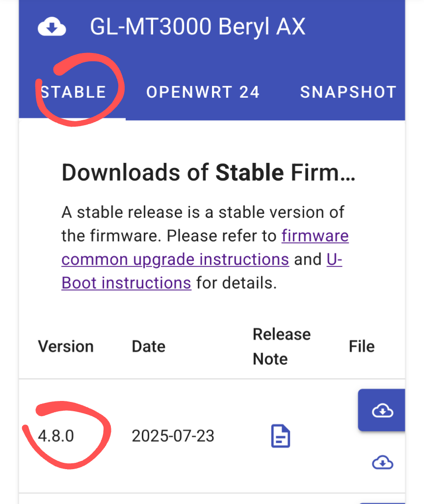

GL-MT3000 is on Stable 4.8.0 (closed source).
We reported the issue with the VPN on Beta (Op24) and the problem is also found on the Stable version.
Funny advice, but the "stable version" IS the problem! It's completely broken.
Im back to running 4.8 stable instead of op24 and do not have the Wireguard / dnsmasq issues.
Its only on op24 for me.
Im seeing nothing broken at all on any of the features i use on the v21 4.8 stable.
Admittedly i dont use or need Dyndns but im using everything else including wireguard client mode.
