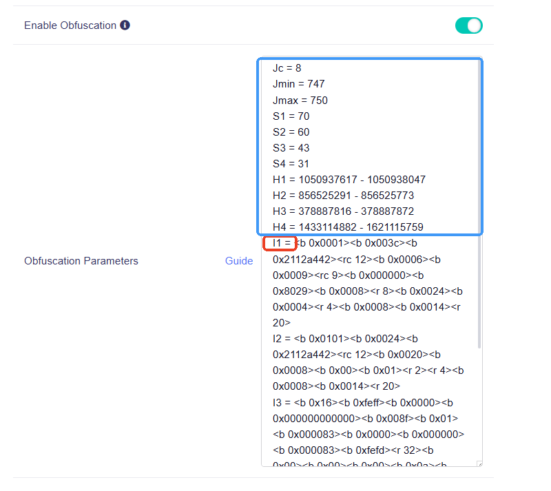

With proper configuration, parameters I1–I5 can make AmneziaWG traffic resemble other protocols. For example, they can help certain firewalls interpret the traffic as QUIC or WebRTC, which may improve connectivity in restrictive network environments.
You only need to add the following fields to your configuration:

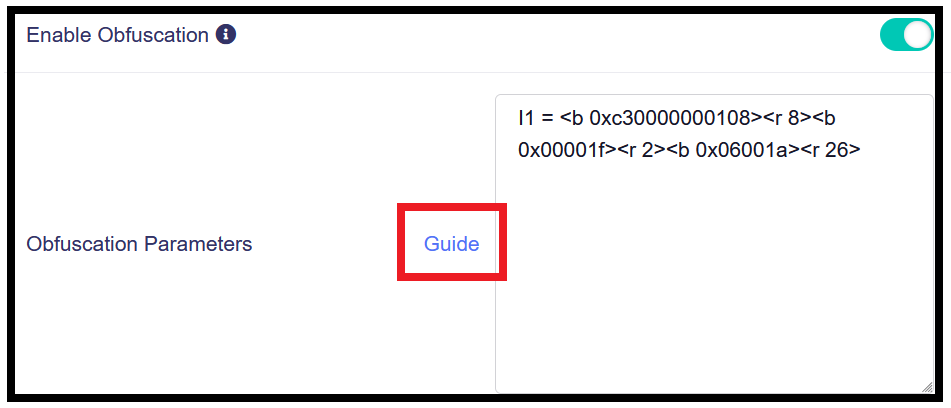

Is this the parameter that you are talking about?

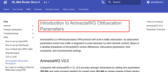

The link “Guide” is going to a “Page not found”.
You may want to click “Apply” after enabling the obfuscation option, so the router can generate the base obfuscation parameters for you. After that, if needed, you can simply append the parameters mentioned above (used for protocol impersonation) to the existing configuration.
I also gave the guide a quick try on my side and it opened without any issues. It might just be related to network conditions when accessing the GL.iNet website from your region.
