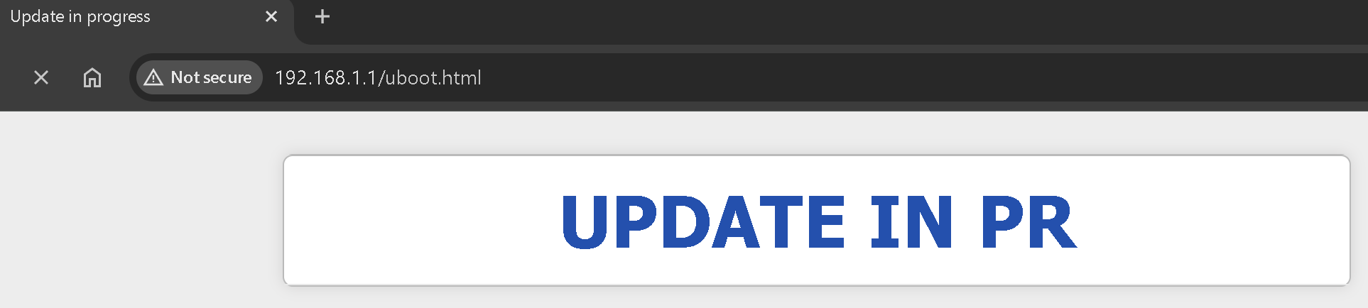

What I found did after your emailI: access the web UI for uBoot; started the process. The UI displays "Update in PR" banner once I click update.
it does not provide any visual feedback on the router. The same first two LED's stay on, and no change in IP from 192.168.1.1.
It does not look like is doing anything.
I have a ping -t going and it does successfully ping 5 minutes after I started the process.

I have started with this screen:
After pressing the Update U-Boot button, a new screen is rendered:
no feedback on router (AE: no changes in LED's first 2 are staying on).
after 25+ minutes, there is still traffic over Ethernet, no changes on router

When I flash the uboot-gl-mt300n-v2-20180427-md5-9285371a147773e26fc687cd3318d480.bin in 192.168.1.1/uboot.html, it did show the "update in pr`. However the mt300nv2 will reboot automatically when it completed flashed, and the first (power) and third(wifi) LEDs will on when it booted up.
