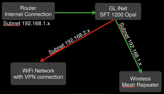

That is my setup.
One router is connected to the internet and the Opal is connected to this router via WAN port.
A wireless mesh extender is connected to the Opal via LAN port 1.
The extender shall be in the same subnet like the internet connected router.
The Opal router shall do a wireless network and sent all the traffic from this wireless network through a VPN (WireGuard).

Did the drawing help to understand my needs?

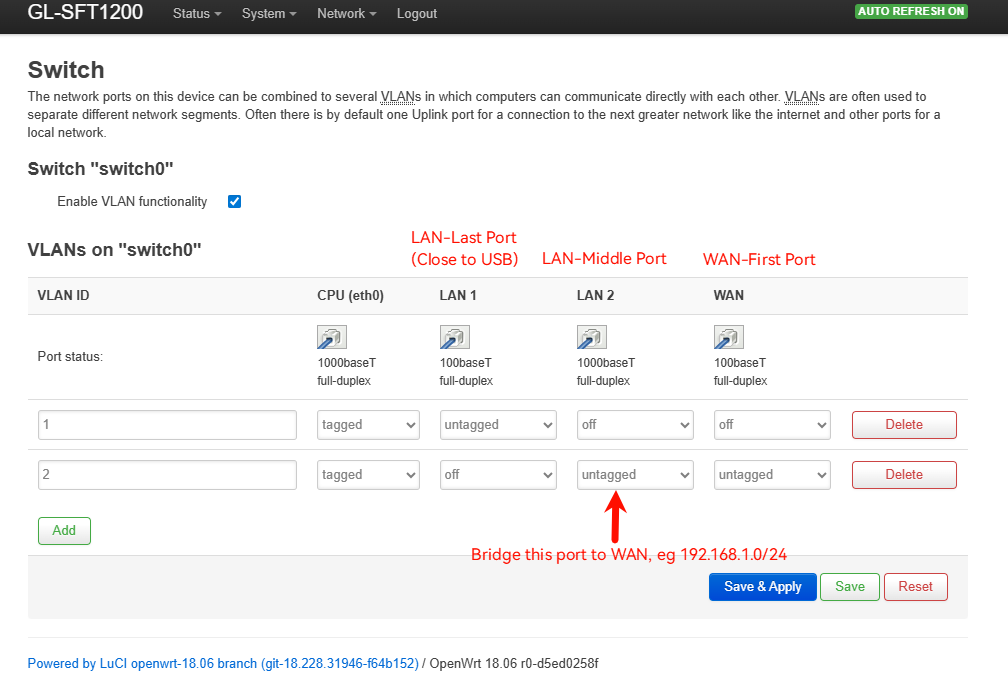

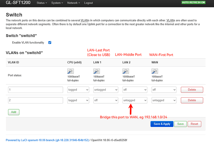

Luci -> Network -> Switch:
Modify as the below screenshot for the Physical Middle Port, VLAN ID 1 off, VLAN ID 2 untagged
As bridge the Middle LAN port and WAN port, the Mesh extender connects to the Middle LAN port will be directly to WAN (Main router subnet) without through routing and VPN of SFT1200.
Thx so much! Worked!
