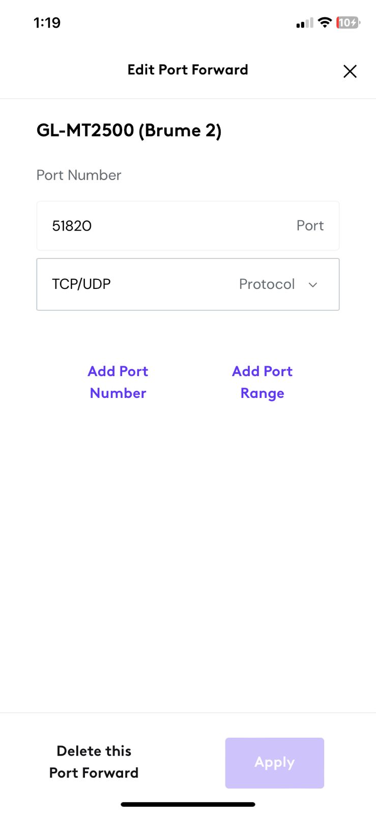

Ah… Can you screenshot how the port forward looks like in xfinity? :slight_smile:
Um, what is this 10.0.0.x address?
Do you use 10.0.0.x as your home network address? This causes trouble because WG uses this network as well.
WG network must be different than your local one.
I don’t know. That is the IP address that shows up as the device IP. Like I said, I know nothing about networking. I’m looking for some help in setting up a VPN (either WireGuard or OpenVPN) so I can reach it with a Beryl AX when I travel abroad. Does GL.iNET ever do web support calls so they can see what is configured and can troubleshoot?
