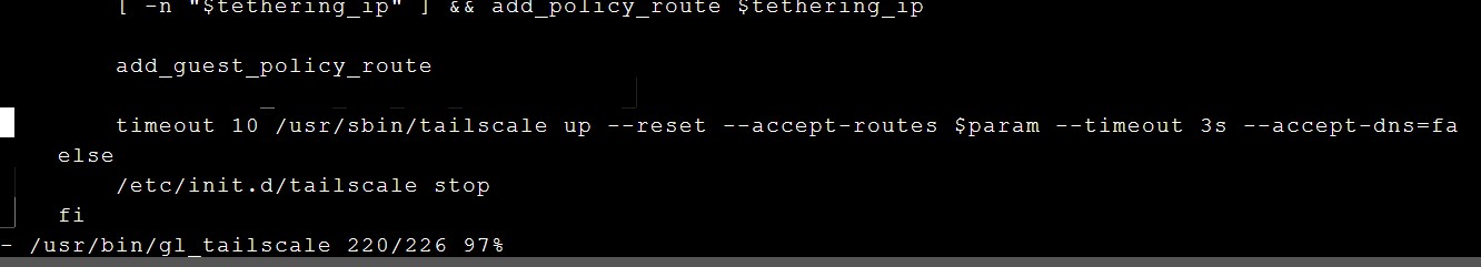

Line 220/224 is edited as follows but the exit node is not being advertized
 timeout 10 /usr/sbin/tailscale up --advertise-exit-node --reset --accept
    else
Change that line to /usr/sbin/tailscale up --reset --advertise-exit-node --accept-routes $param --timeout 3s > /dev/null then reboot

I just use /usr/sbin/tailscale up --advertise-exit-node --reset $param --timeout 3s
Redirects all output to /dev/null which means there is no output at all.
No usage at all, just for cleaner terminal output.
