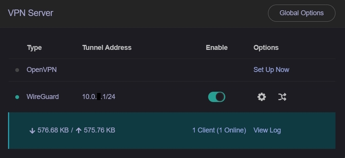

More back on topic: given the aforemetinoned netifd + WG aspect, does this Internet/VPN dropout occur when after all devices are connected first (eg: though the switch), then the Burme2 is rebooted w/ the VPN still engaged (read: set to automatically connect to WG on boot?):
2023-12-14 09_33_17-GL.iNet Admin Panel - Chromium
(I’d like to point out I wouldn’t expect the whole network’s connected devices to be ‘bumped offline’ just because someone connected another bit of CAT to the switch. You may have discovered something ‘not quite right’ in the GL firmware.)
