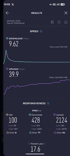

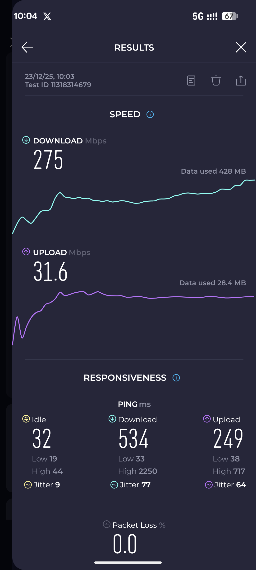

Additionally, I have tried speed tests from my mobile when I have faster up down speed (results attached). The test without WireGuard was 275/31.6 and with 9.62/39.9 so it looks like the upload speed is unaffected.

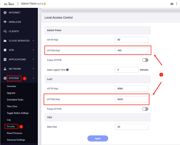

Is this possible on the brume 2? I can’t change the port to 443 or 8443 in the WireGuard GUI.
Please go to System - Security and change the Admin Panel or Luci port from 443 / 8443 to another port first.
Then you should be able to change the WireGuard server port.
