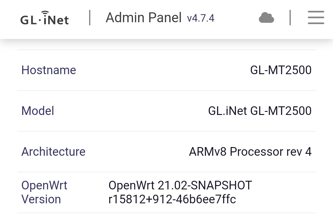

Well, I have the same issue as described above, upgrading a Brume 2 from 4.7 to 4.7.4. Additionally, after normal boot the device is not responding and in LAN does not respond to DHCP DISCOVER messages. I have contacted support for advise how to proceed - waiting for their feedback. I have a second brume 2 on 4.7 but I will hold back the upgrade to 4.7.4 until clearance from support team.

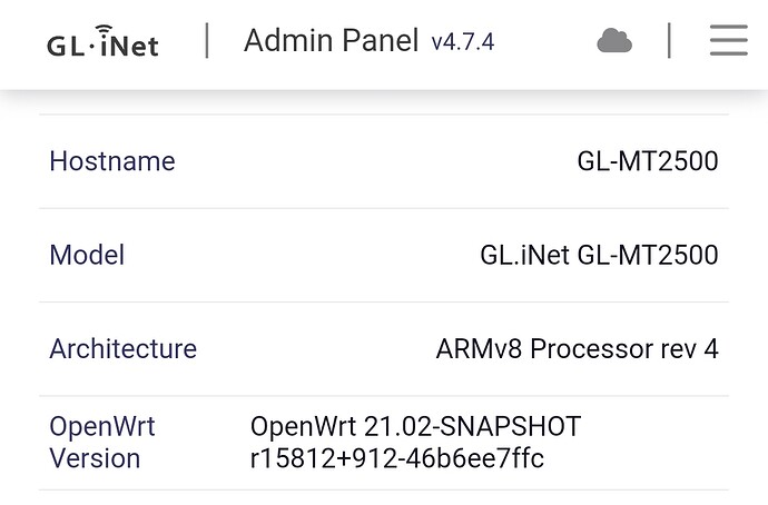

I don't have problem updating my brume2 to the latest uboot and firmware.
Thanks Kaz,
Update from my side - the particular unit is probably totally bricked. I tried with another Brume 2 unit I have and everything is fine indeed.
Thanks a lot to the GL Inet support team - they have been very supportive. According to them this particular unit is indeed bricked.
