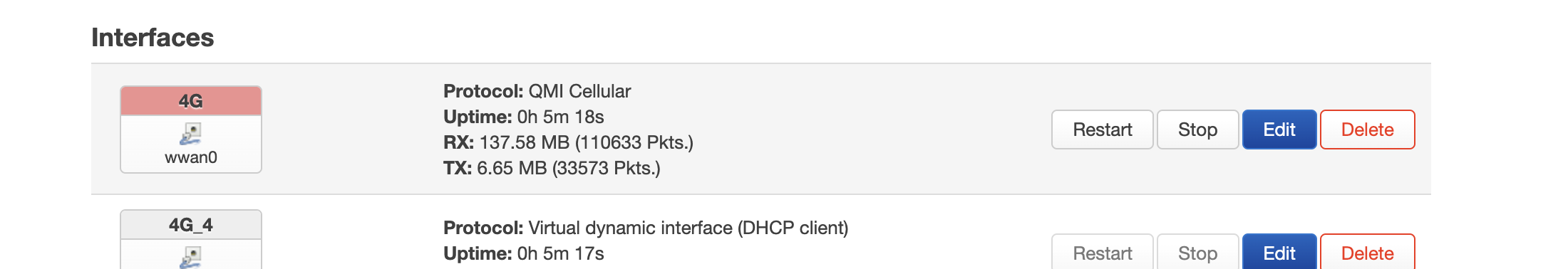

I’m trying to use a usb hub to connect a usb modem to the brume 2 and show up in the web gui. I have successfully got the modem connected and running on the luci side of the router. The interface for it has been configured and I do have internet access. But on the gl.inet’s brume gui, it shows nothing for a modem. If i plug the modem directly into the brume, it will pop up.
