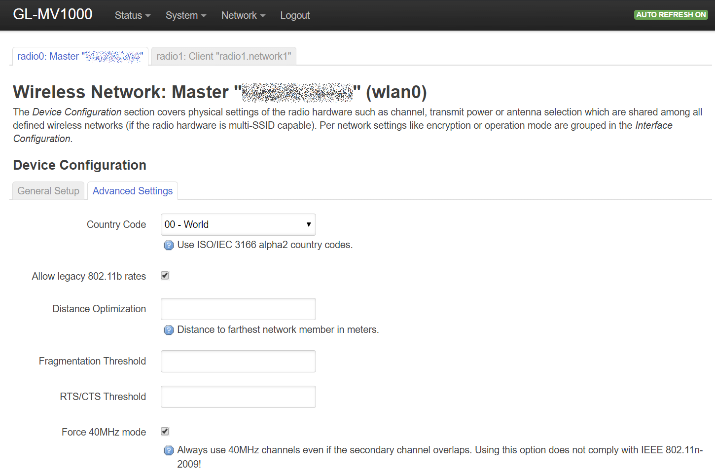

Under Device Configuration, Advanced Settings, I see that Force 40 MHz is checked while I selected 80 MHz in the main interface.
So, which one is it ? 80 or 40 MHz ?
