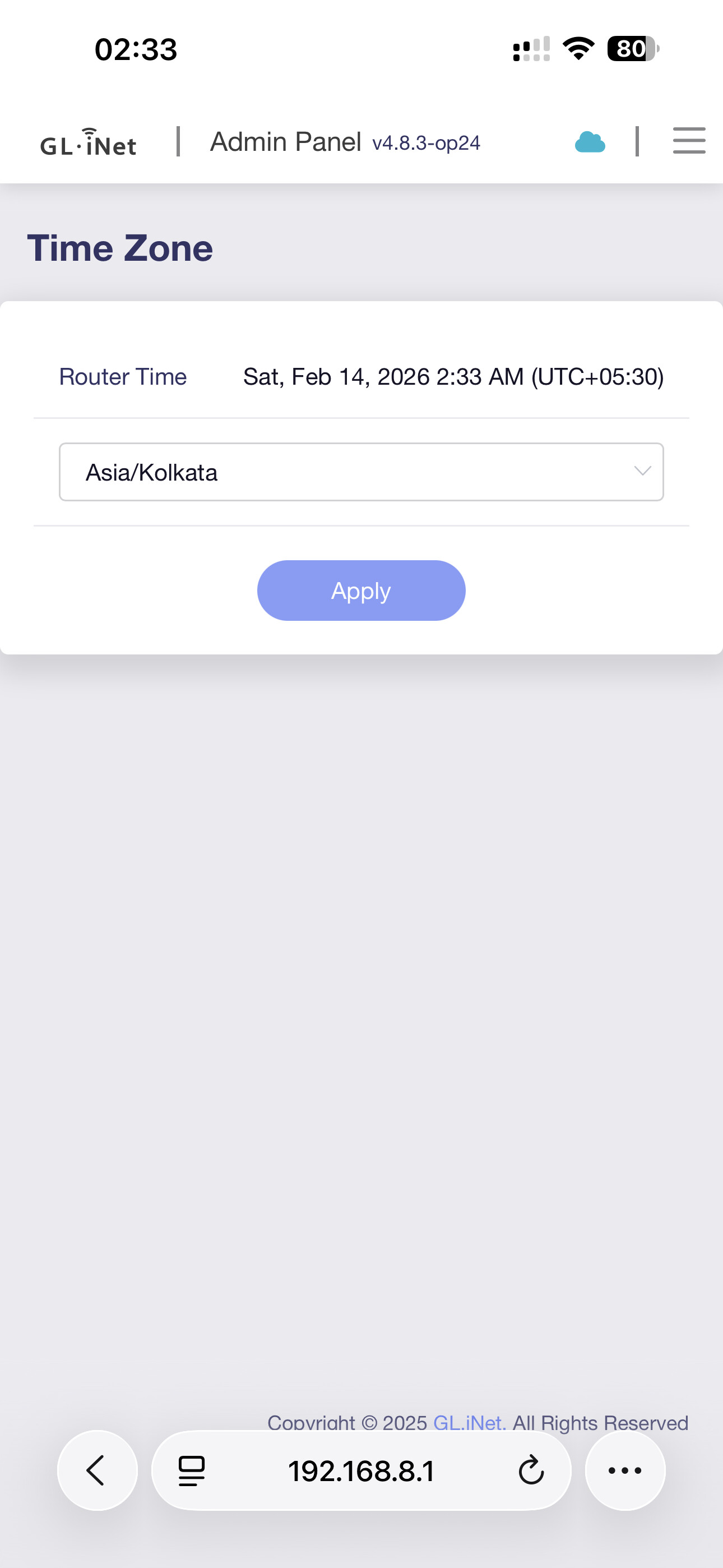

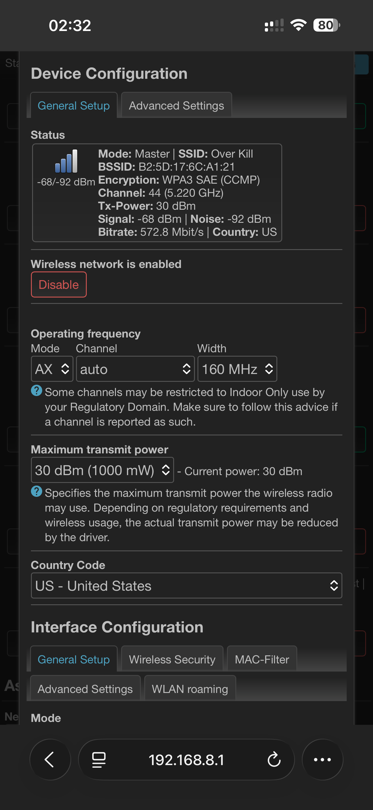

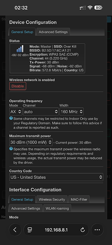

Even though my area is set to India, the WiFi in luci settings defaults to USA. This causes my 160mhz to malfunction sometimes.
I am on the latest openwrt-24 build.

When IN is selected for 160mhz the network fails to start.

After switching back to 80mhz the network will work normally

Change the setting to IN in both Wifi interfaces # disregard error
Reboot the router
Check your settings see if it worked
EDIT: You could SSH into the router and set it to the proper country
iw reg get
iw reg set US
uci set wireless.radio0.country=US
uci set wireless.radio1.country=US
uci commit wireless
Yes I had rebooted after setting IN but 5ghz will fail to start if set to 160mhz.
Have set it back to US now.
After some research I’ve got to know that the fault lies in Indian implementation of DFS and this is not something that can be resolved now.
The best way forward would be to completely ignore DFS channels for now.
