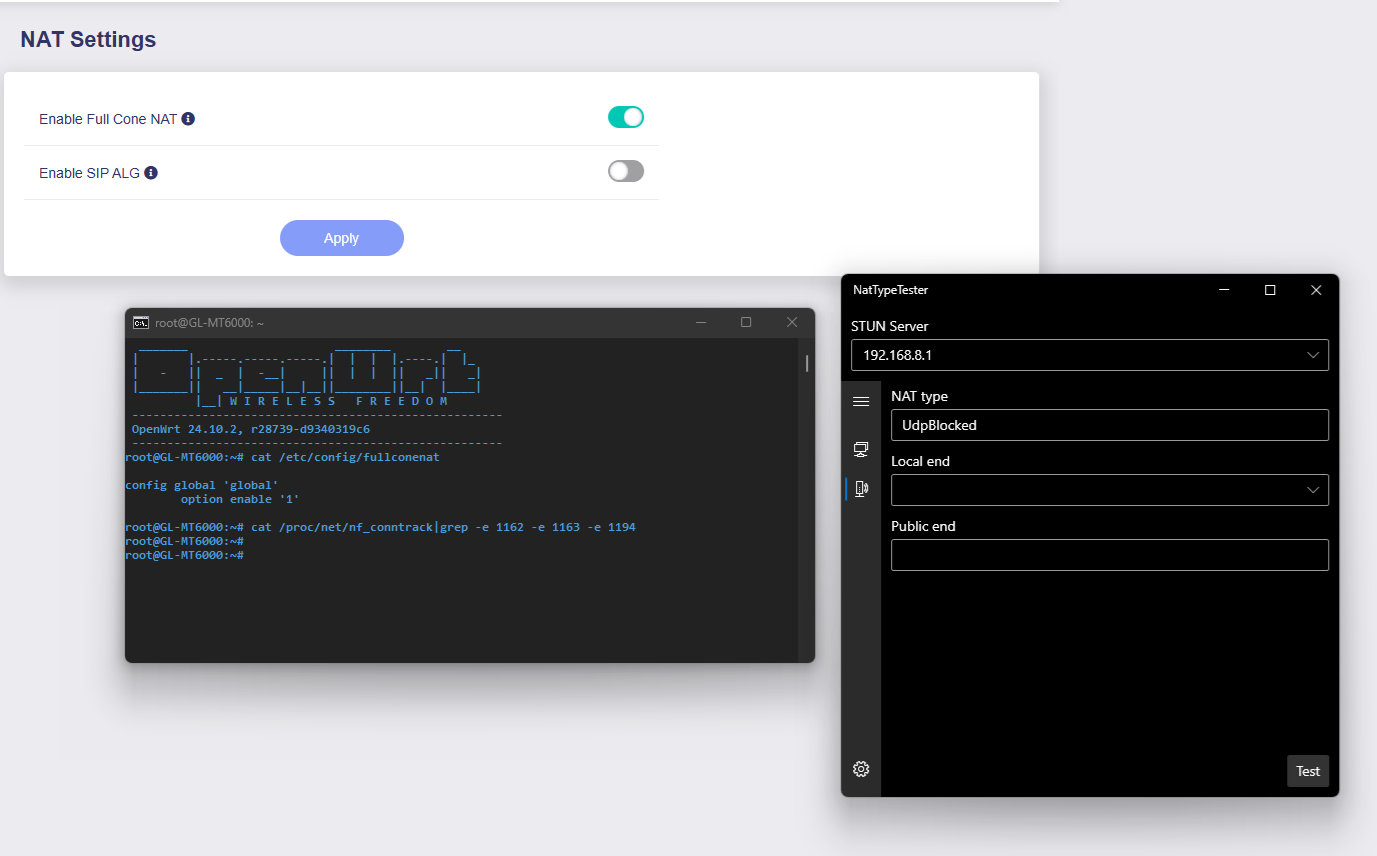

Hi guys. Can you help me? I have full NAT enabled, but when I run the test, it says "UDP blocked."
If you use NatTypeTest (software/tool) to test in local, you need to set up a NAT test server on the WAN side of the router and local test.
