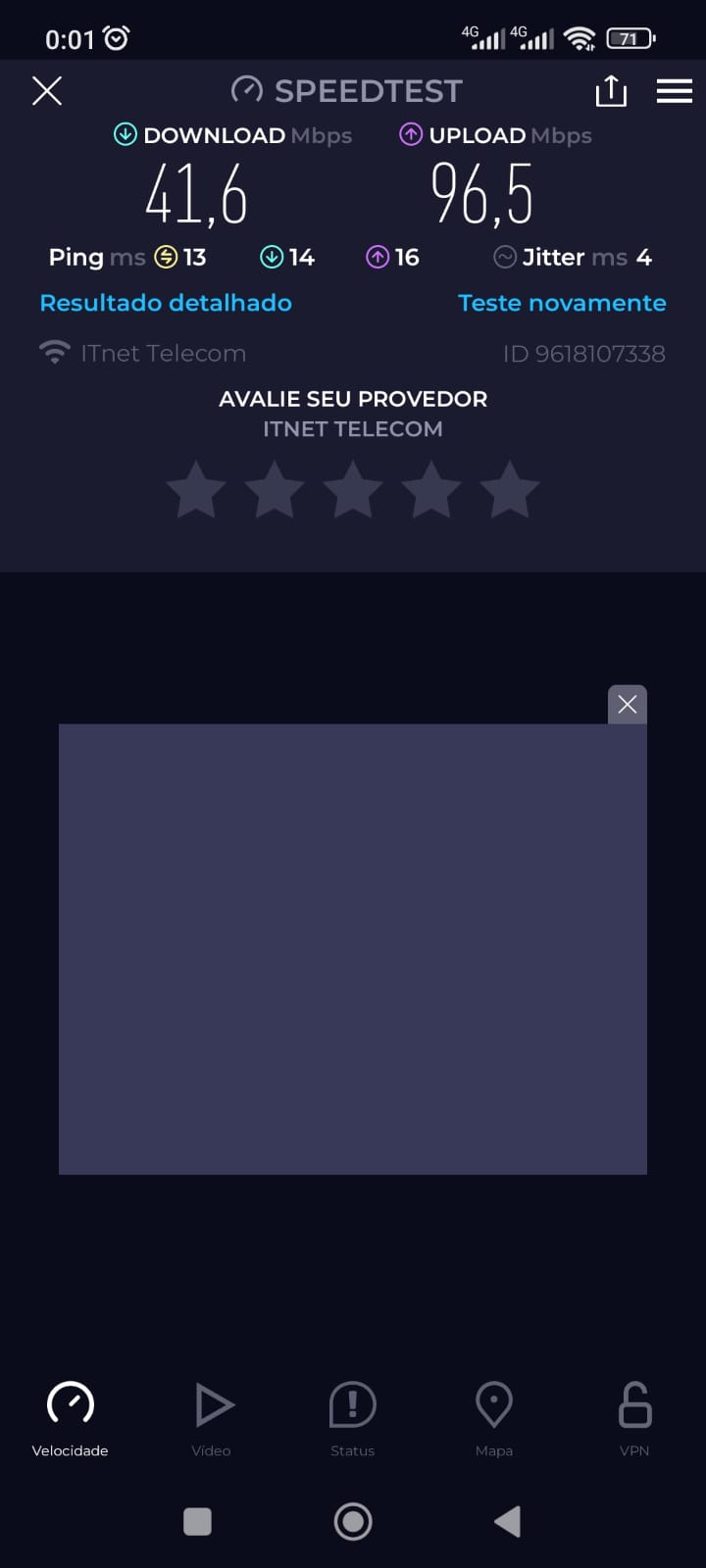

Is there anything new about the speed limit when choosing the repeater?
From 230MB it drops to 30MB.
Wi-fi GL-AX1800 5G (Repeater Internet)

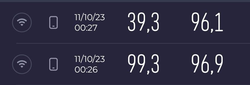

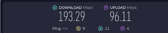

See an example below. in 11 minutes the download speed dropped while on the repeater router it is normal.
At a certain point everything is normal and out of nowhere the download speed drops.
It’s the same Wi-Fi as the GL-AX1800 (5G) using the repeater as the main network.

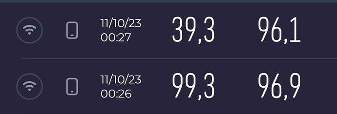

Another example of the problem.
The two tests were carried out on the GL-AX1800’s 5G with the repeater as the main internet.
Observe the speed drop in 1 minute difference

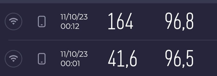

It happened again.

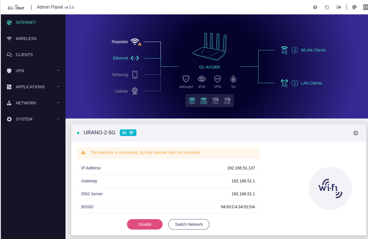

" The interface is connected, but the Internet can’t be accessed"

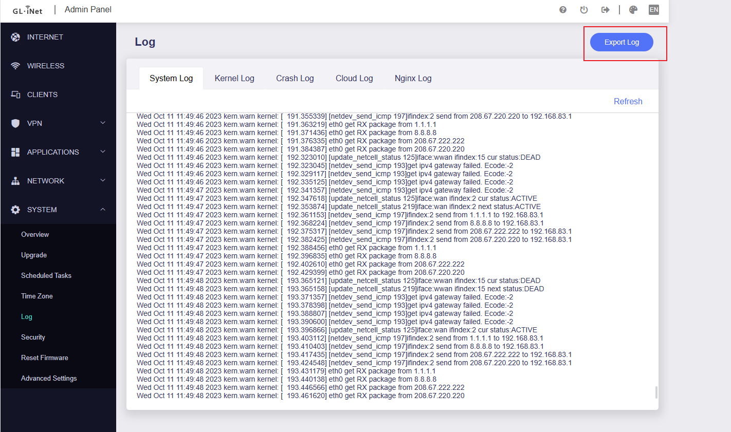

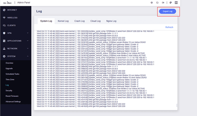

I ran echo 3 > /proc/gl-kmwan/debug before
Where can I get the log to send?
I changed it to 10s, but the problem really remains even without VPN activated.
Hi, about this question,can you run following command via ssh during testing and send it to me:
while true; do iw wlan-sta0 station dump;echo *****************; iw wlan1 station dump;echo **********************; sleep 3;done
Thank you!
Log.

Hello, at present, I have only reproduced this problem on the ax1800, and the temporary solution is as follows:
First disconnect all network connections from the wan port, then connect the repeater(the repeater must be the first connection), and then connect the others (such as cable,modem, etc.).

Yes, you must ensure that the repeater is the first to connect, otherwise the relay interface will have a problem state.We’ll fix it as soon as possible.
I did it.
But if I then invert it in Interface Priority the error returns.
