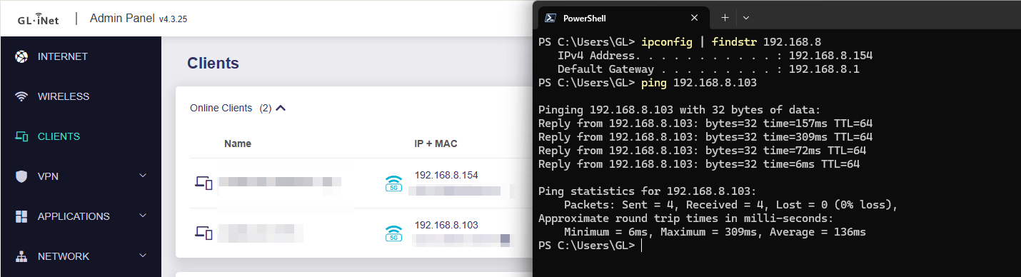

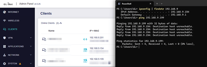

We tested locally using MT1300 v4.3.25, but we were unable to reproduce the issue.
Although ap_isolate=1 appears in the hostapd configuration file, the actual isolation behavior still follows the settings defined in UCI.
Main Wi-Fi:
Guest Wi-Fi:
