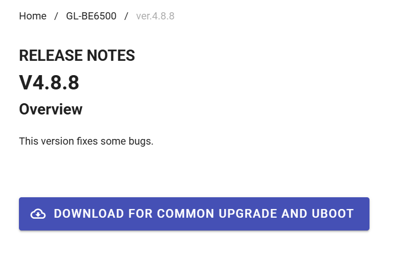

Also, I noticed that firmware updates for other models usually include release notes or changelogs, but on the BE6500 firmware update page, there are usually no version notes available when updating the firmware. This makes it hard to know what issues have been fixed, what has changed, or what new features have been added.
I hope release notes or a changelog can also be added to the BE6500 firmware update page in the future.
Thank you.
We'll try to notify you once the issue has been fixed.
Thank you for your feedback. We'll discuss with the development team how we can improve the BE6500 firmware release notes in future releases.
