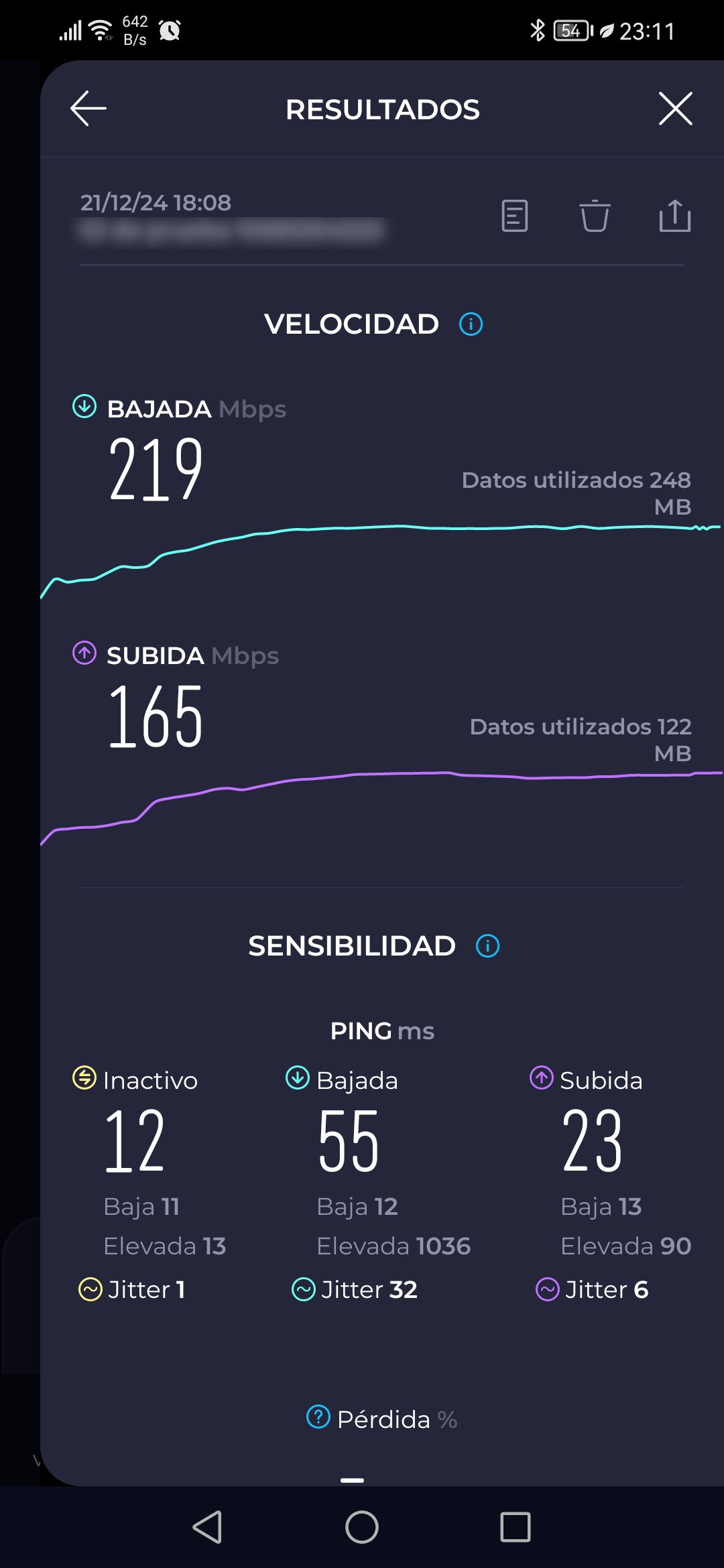

On v4.6.2 downgraded firmware
On v4.6.8 (v4.7.0 has very similar results)
