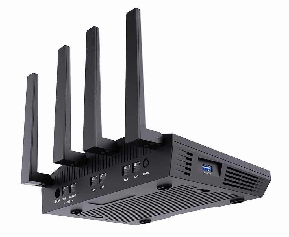

Most, if not all of the, home routers can be wall mounted. There should be a couple of '<=O' drywall screw/nail slots on ea. side of the base. See below, this is the Flint v2:
The antenna's fixed right angle might be bothersome when wall mounted. If that's the case the Beryl AX's antennas have more rotation if used as a AP/Extender. Just find a nice wall mount to print for it. It also has native builds of OWRT available from OWRT themselves.
