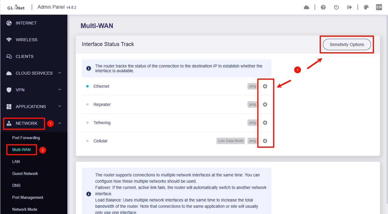

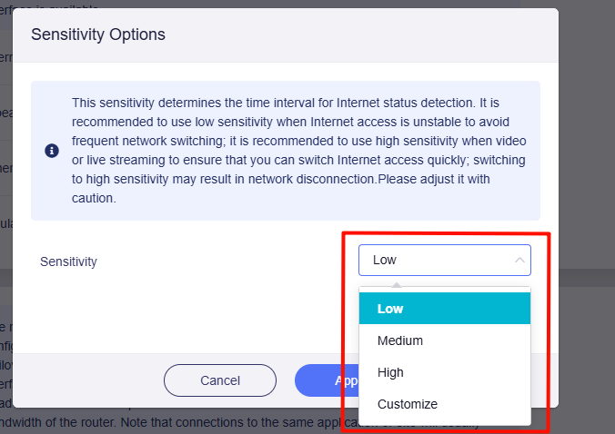

The 4.8.x firmware series includes updated logic for detecting internet availability. In some environments, this may lead to false positives even when connectivity is normal.
You may try the following under Admin Panel > Network > Multi-WAN:

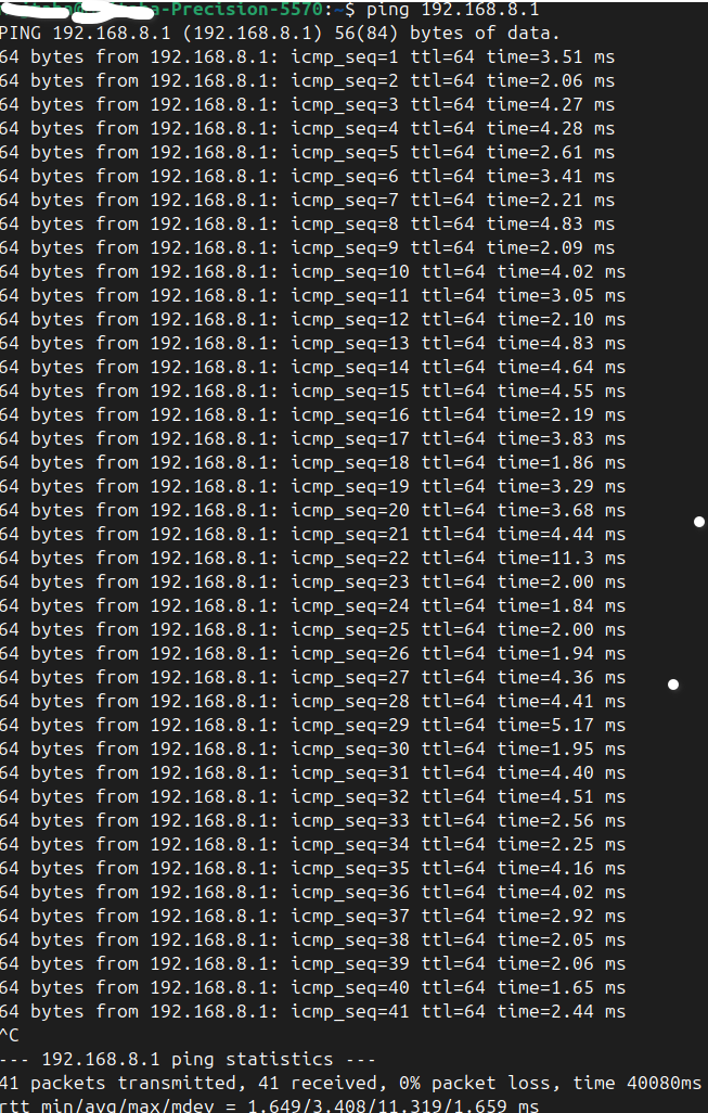

  4. Run a continuous ping to the router’s LAN IP (default 192.168.8.1) from the Linux device to check for packet loss.

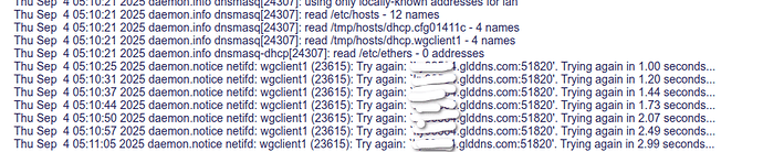

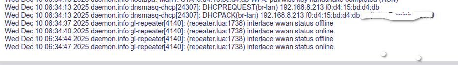

and this comes up when I connect my linux laptop
This is what ping shows.

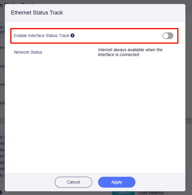

I did the first option but after doing that my vpn connection does not go through. It kept on trying until I enabled interface status track.
Moreover, the connection works fine if I am on a mobile or a windows laptop. But keeps blinking when I connect my Linux laptop.
Moving to the second resolution, I am using a wireless connection on linux and no the laptop does not disconnects from the router. It stays connected but without internet.
