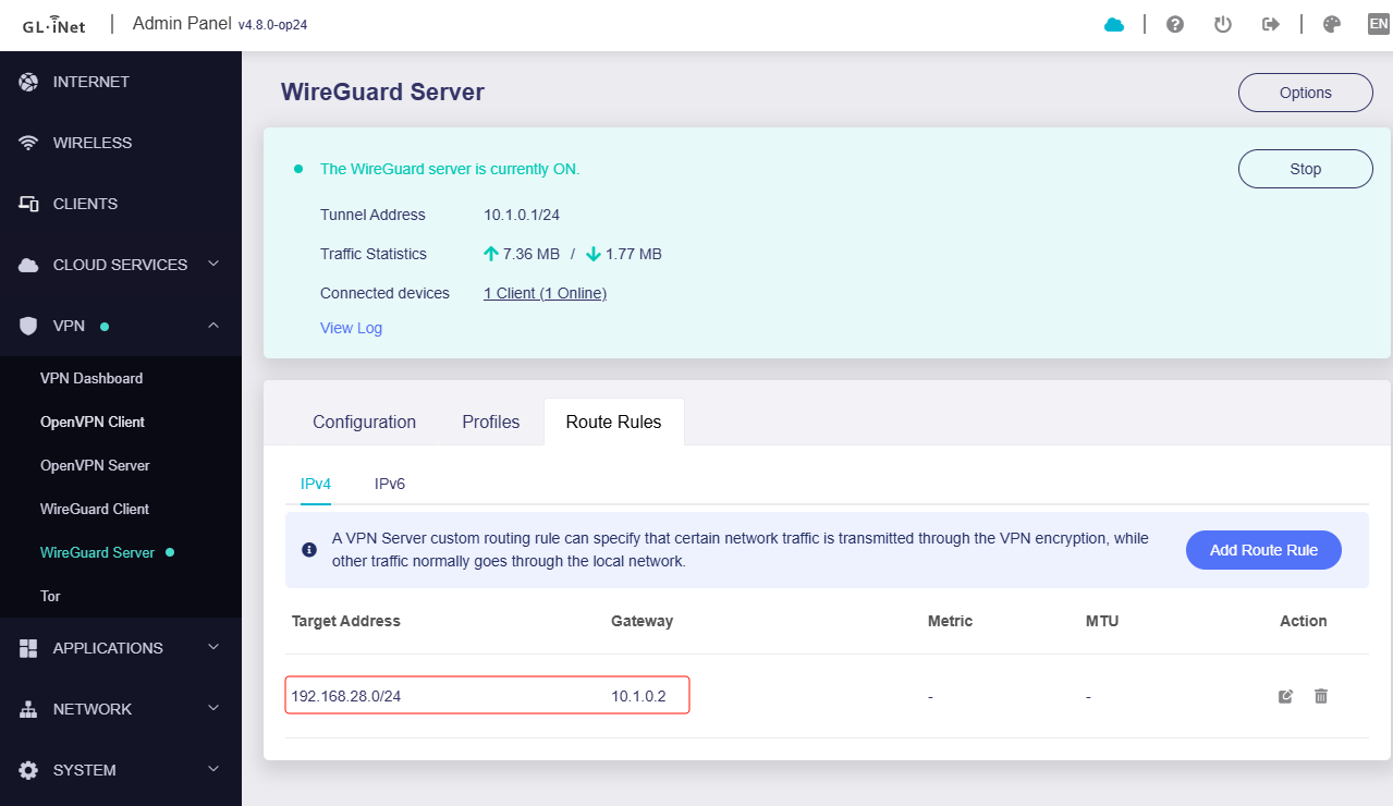

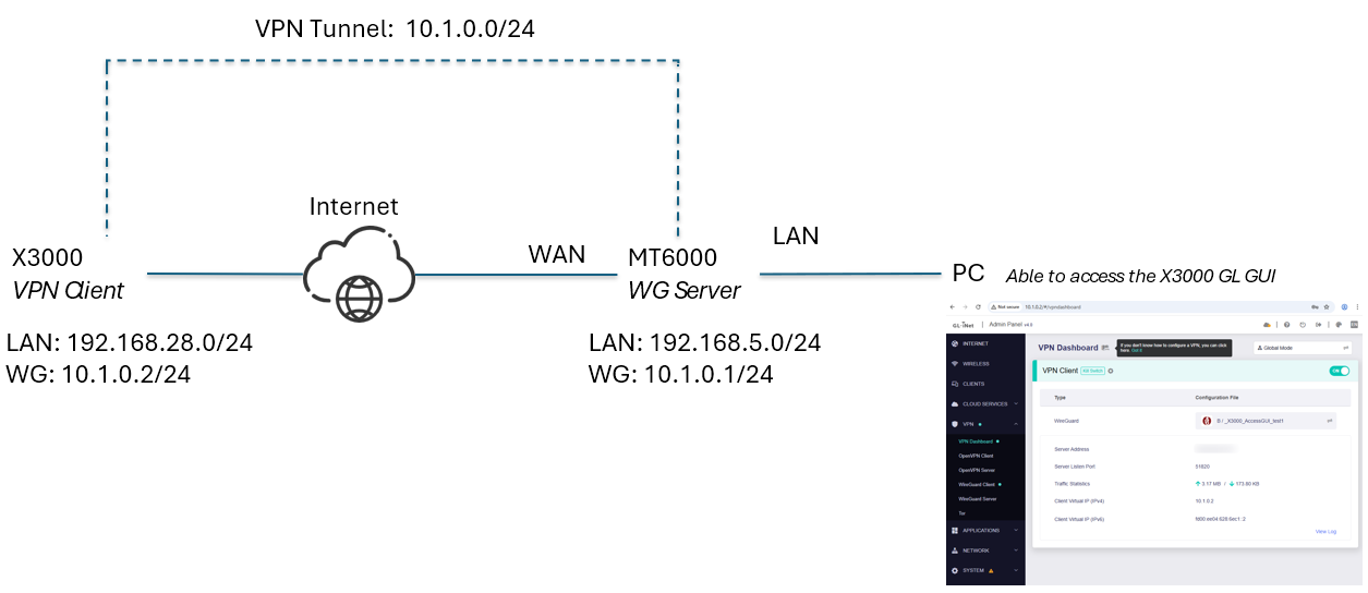

The topological connection has not changed, but only the LAN IP of X3000 has changed:

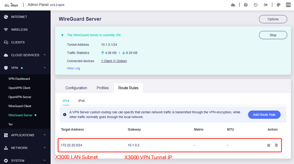

MT6000 is a VPN server, adding static routing:

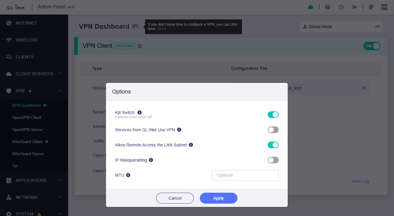

X3000 is a VPN client, and disable IP Masquerading:
The test PC is a LAN client connected to the MT6000.

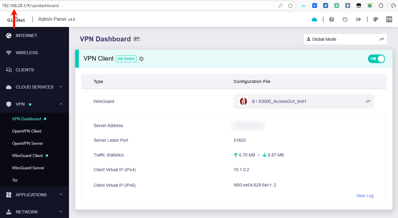

Through X3000 LAN IP and Tunnel IP, access the GL GUI of X3000 in the browser, normal:
PC CMD, ping [X3000's LAN client IP], normal:

Please enable the Allow Remote Access the LAN Subnet, and access the GL GUI via the X3000 VPN tunnel IP, like 10.1.0.2

Hi, using the IP of the VPN tunnel works correctly. I can open the X3000 web interface Unfortunately the server is a ubiquiti UDM pro, can’t share the access.

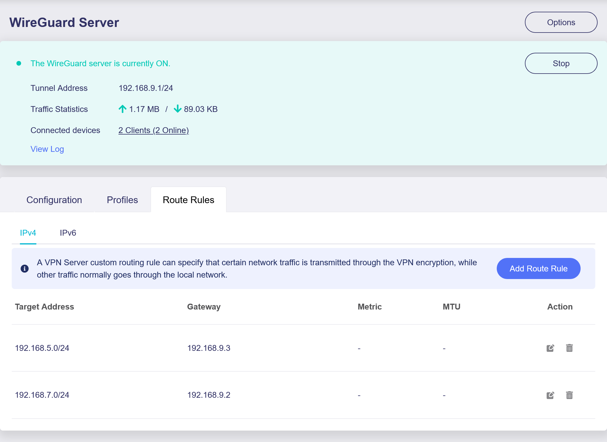

On the server, I have the route rules configured to access the clients (see picture):
Please note that there is a difference from the previous version that is not yet updated in the documentation: the fact that there is no scope field, which had to be configured as global previously.

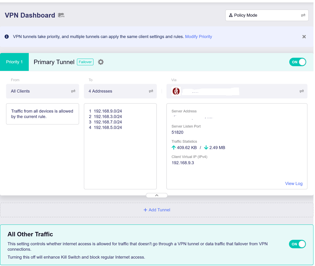

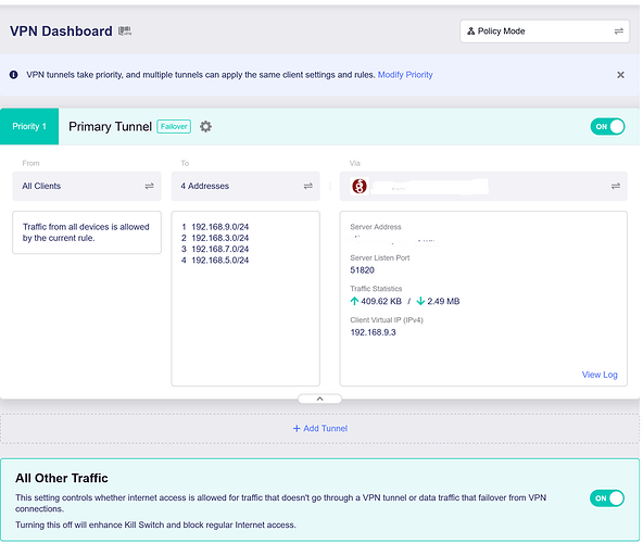

Finally, I have the clients in Policy Mode to route only the other client, server and wireguard traffic through the VPN (I also added its own addresses just to see if it would make any difference, but it doesn’t):
I’ve also gone through lucy to see if there was something strange in the configuration, but I did not find anything.

Your VPN tunnel is using 192.168.9.0/24 segment, right?
This network segment is used in the GL firmware for Guest Network.
Please change the subnet of the Guest Network or change the subnet of the VPN tunnel.
Please add static routes on the VPN server:
Please check if your VPN server is enabled "Client to Client"

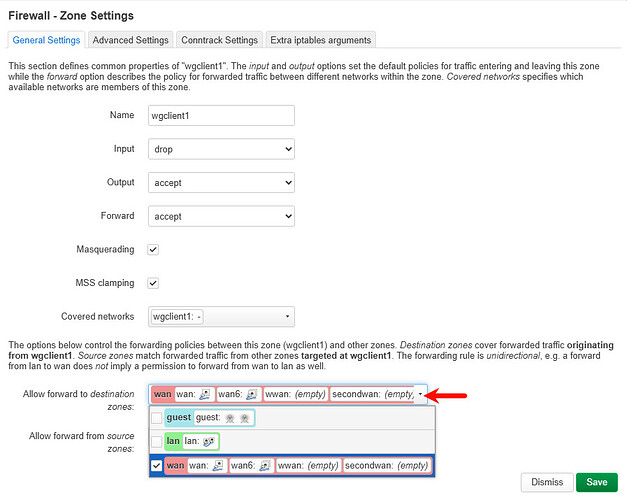

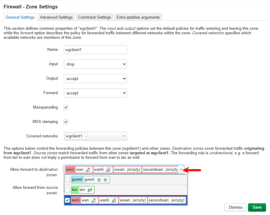

You can enable forwarding for the wgclient/ovpnclient > WAN in Luci Firewall of VPN client router if with v4.8.x firmware, so that VPN server side access the LAN subnet of the VPN client without any problems, and access the primary WAN subnet of the VPN client also without any problems.
