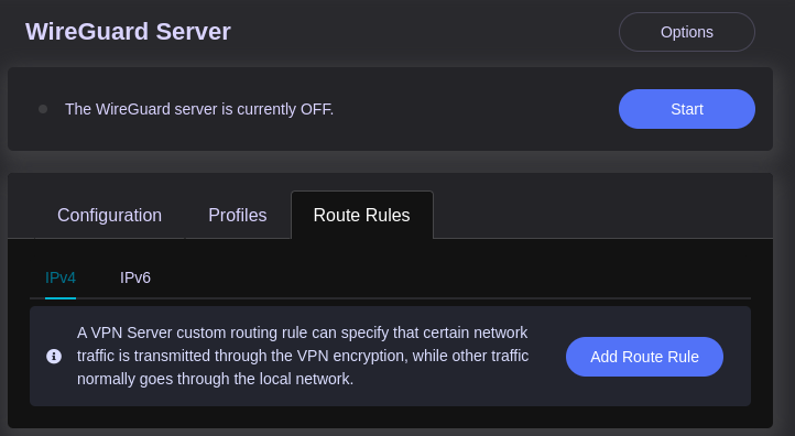

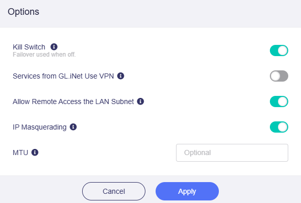

These screen caps and config files are from my 4.7 install, just level setting for your to try to reproduce if you get time.

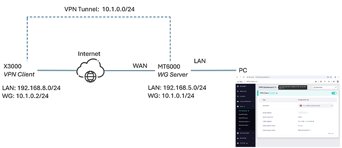

I tested in my routers, and did not reproduce this issue.

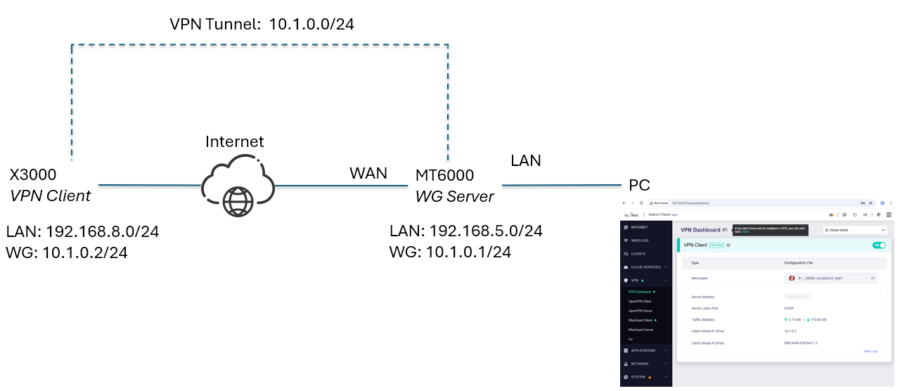

Network Topology, it is similar with yours:
X3000 FW is v4.8.2, 0819, and connected to MT6000 via WG.

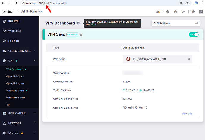

The PC under the MT6000 (WG server) is able to access the X3000 GUI via 10.1.0.2 in browser:

And maybe you want to use masquarading in order for port translation to work, without this port forwarding between the wireguard server and lan is not possible.

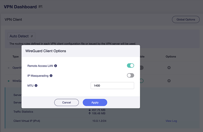

I have a separate subnet for the RV and home wireguard connection. I mimicked what my Flint2 had when I moved to my Debian server. I don't need masquerading. My debian server is 10.0.1.1/24 and my RV router is 10.0.1.2/24.

I will try to disable the IP masquerading in WG server and test again, if this is the difference between your topology and mine.
