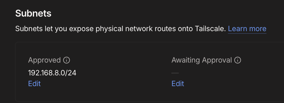

My raspberrypi is running a tailscale exit node and gl-inet mt-3000 router is advertising routes which are approved in tailscale admin console:
This network/routes are accepted by raspberrypi.

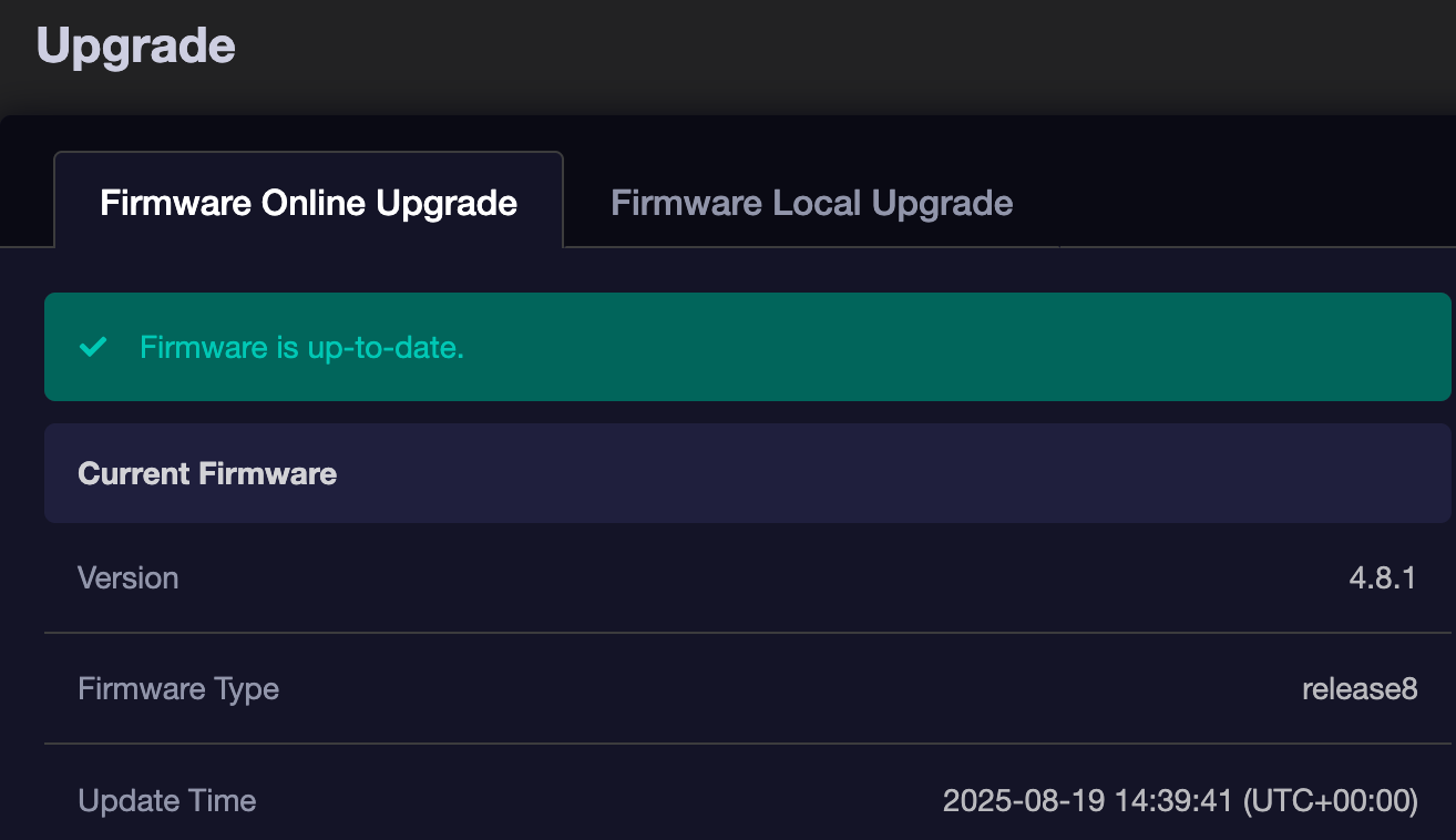

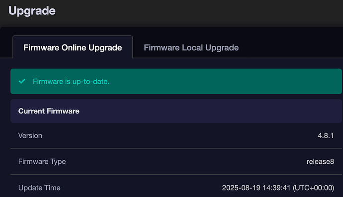

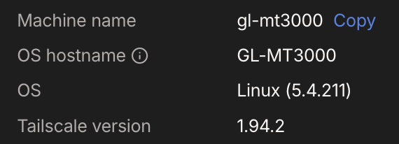

Versions:
Latest tailscale version on gl-inet mt-3000 at the moment of writing this:
Latest router os version:

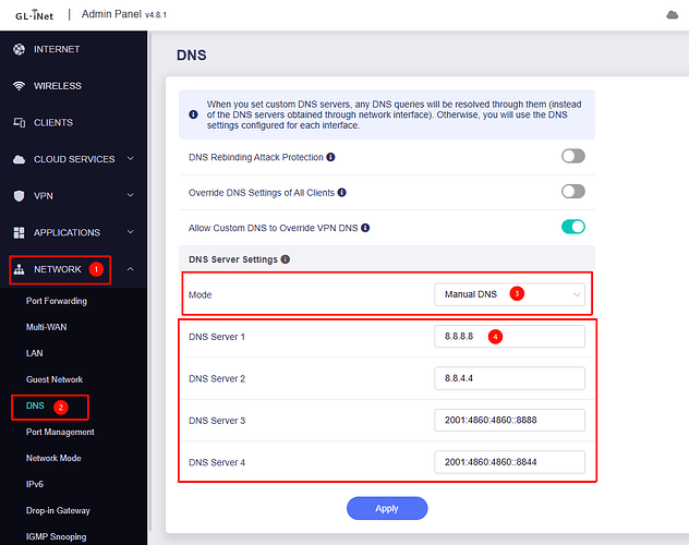

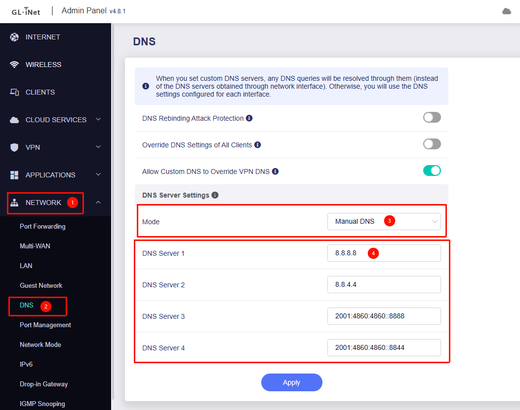

In some situations, the DNS addresses obtained by the router may not be accessible through Tailscale. You can resolve this by setting a custom DNS under Admin Panel → Network → DNS.

I did follow that guide and even updated the dns but still no internet as soon as select the exit node in the router’s ui.

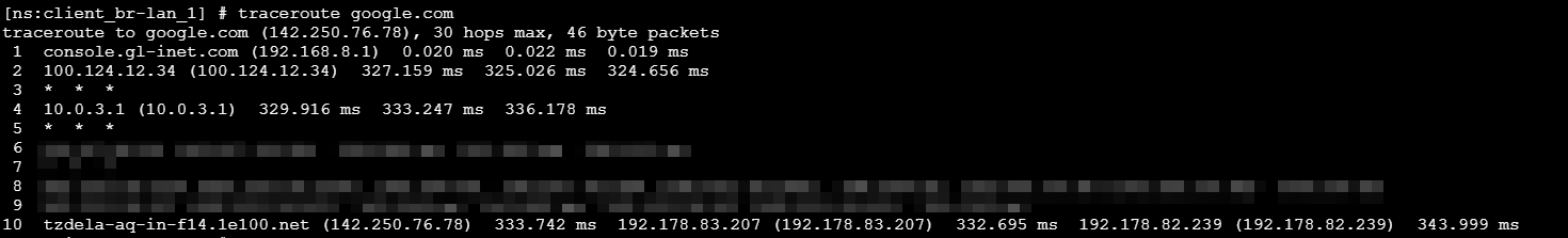

If so, would you be able to share the nslookup and traceroute results mentioned earlier?

This is with the mt-3000 after resetting and enabling tailscale from the web console with custom exit node selected, and on the tailscale side approving the advertised routes and with custom google dns servers.

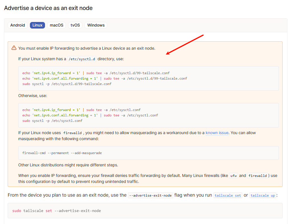

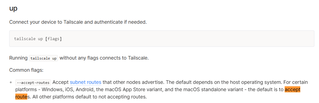

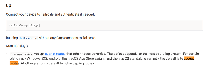

Please note that you need to enable IP forwarding, IP masquerading, and route acceptance when enabling Tailscale on the Raspberry Pi—these are required for it to function as an exit node.
Refer: Exit nodes (route all traffic) · Tailscale Docs
Refer:Tailscale CLI · Tailscale Docs

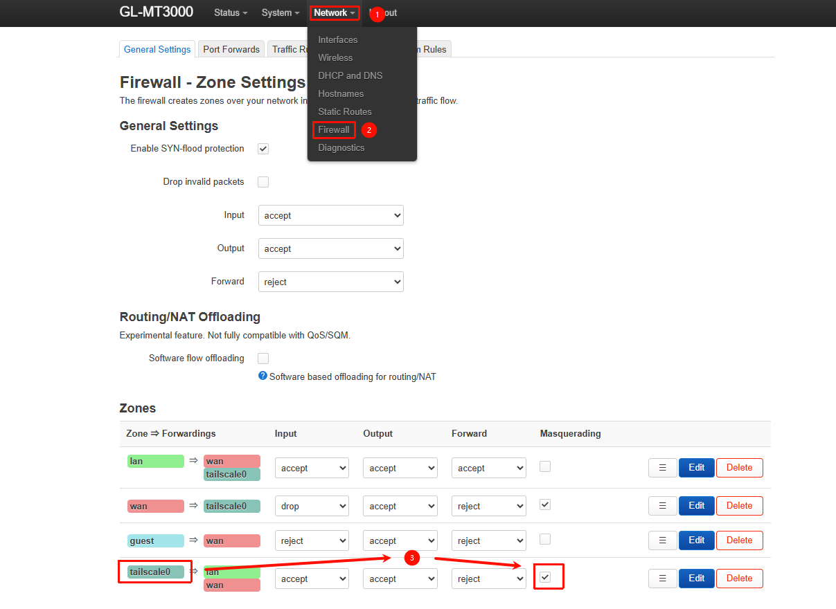

After performing a remote check via GoodCloud, we found that enabling IP masquerading for the Tailscale zone under LuCI → Network → Firewall allows the Raspberry Pi to function properly as an exit node.
This suggests the issue is likely due to the Raspberry Pi not accepting the routes advertised by the MT3000—meaning it doesn’t have a return path.
We recommend:
  1. Keeping IP masquerading enabled for the Tailscale zone. However, note that the Raspberry Pi or other Tailscale nodes won’t be able to distinguish MT3000 LAN devices (the source address will appear as the Tailnet IP of MT3000 instead of 192.168.8.0/24)
  2. Checking the Tailscale configuration on the Raspberry Pi to ensure it properly accepts the routes advertised by the MT3000
Yes, the pi does accept routes advertised by gl-inet mt-3000.

Once the exit node is configured correctly, enabling “IP masquerading” in the Tailscale firewall zone is no longer necessary.
