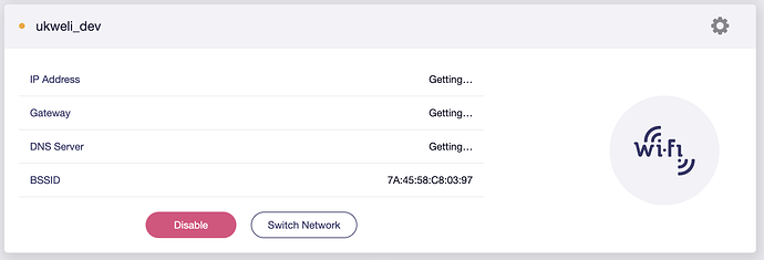

I am able to get it connected, but it doesn’t pull an address:
Update:
Two networks in question:
  1. ukweli_low (WPA2/WPA3, no 802.11r)
  2. ukweli_dev (WPA2/WPA3, 802.11r enabled).
The networks have different passwords but same security, are being served off of the same Ubiquiti APs.
Procedure:
  1. Full reset of MT3000.
  2. Attempt to join ukweli_dev (the 802.11r network). Repeater interface says “connecting” but never connects. Messing around in luci give what I showed above with invalid security, etc.
  3. Attempt to join ukweli_low (the non-802.11r network). Connection works.
  4. Now attempt to join ukweli_dev again. This time it works.
I haven’t had time to spin up other networks and test whether you can join other 802.11r networks, or if it also may have something to do that these are all being served off the same APs. I’ll have to think about how to set something up with an entirely different network name / AP set.
