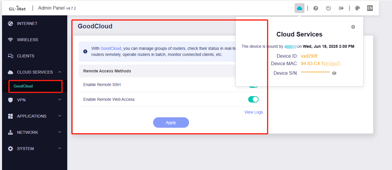

If you use the APP to remotely access the router.
Please check whether the Goodcloud binding of the router is normal and rebind it to your Goodcloud account.
