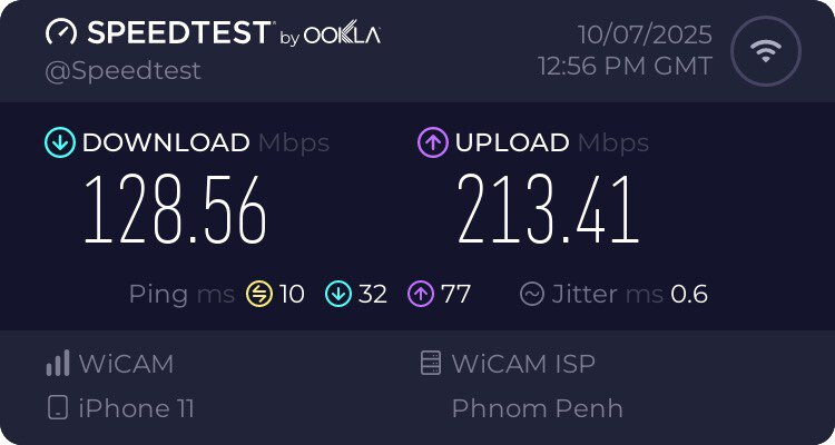

这是我的,AR750S 最新OPENWRT固件,iphone上的测速
You won’t see much above these speeds over wireless if you are using the same router ime.
