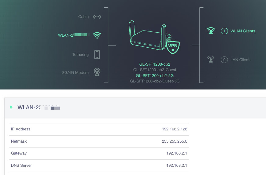

As mentioned, the WireGuard connection works via iOS and macOS from network A. The GL-SFT1200 (network GL) is connected to network A via a modem router to have internet access. When I am in network GL, I cannot establish a WireGuard connection even with the macOS app. Thank you for your approach, I think we need to find the solution here?
First make sure SFT1200 is not in the same network as the Fritzbox.

And the internal IP of the router you are trying to connect from isn’t in 192.168.178.x I hope?
(None of the internal address. Not even guest network)

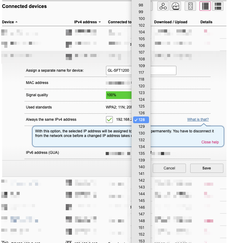

The IP of the router of network A (WLAN-2…) is 192.168.2.1. I can connect from WLAN-2… with WireGuard iOS and macOS app successfully. The GL-SFT1200 (network GL) router, the one that does not connect with WireGuard has the IP 192.168.2.128.
Thanks again so much for your support!
Won’t work.
The network isn’t allowed to overlap.
Change the network of the GL one to something different than 192.168.2.x
You mean change the 128 from the router IP from 192.168.2.128 to anything else?
I am not sure if you understood my correctly.
You can’t connect to a VPN from within the network you want to connect to.
So when using VPN all networks need to be unique.
Consider to use draw.io to draw a small map of your network, like explained here.
