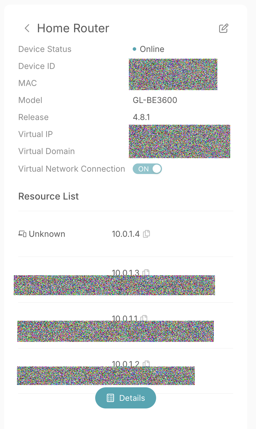

I use two routers, GL.iNet GL-BE3600.
Both are added to the AstroWarp network.
Now my routers are in different locations, and I use one of them as the internet exit point. My external IP on the travel router matches the IP on the home router. So definitely the connection works.
I can open the admin panel of my home router remotely using the AstroWarp connection.
In the AstroWarp configuration for the Home router, I have shared some resources. They have DNS.
These DNSes resolve to IPs, like, 10.0.1.1 and 10.0.1.2, etc
Now is the problem. I can’t access my resources remotely. They don’t respond to PING, HTTP, or HTTPS connections.

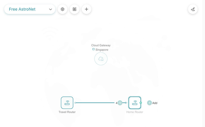

Could you please provide a detailed network topology so we can understand your issue/requirement?
If possible, please send your AstroWarp account and password via private message so we can directly access the device remotely for inspection.
Travel Router (TR) → Home Router (HR)
I connected to TR by Wifi.
TR is connected to HR by AstroWarp
HR has four devices connected.
When I am at home, I can connect to HR directly via WiFi. Then I can connect to any of these four devices.
Through AstroWarp (TR) I can only open the admin page of HR.

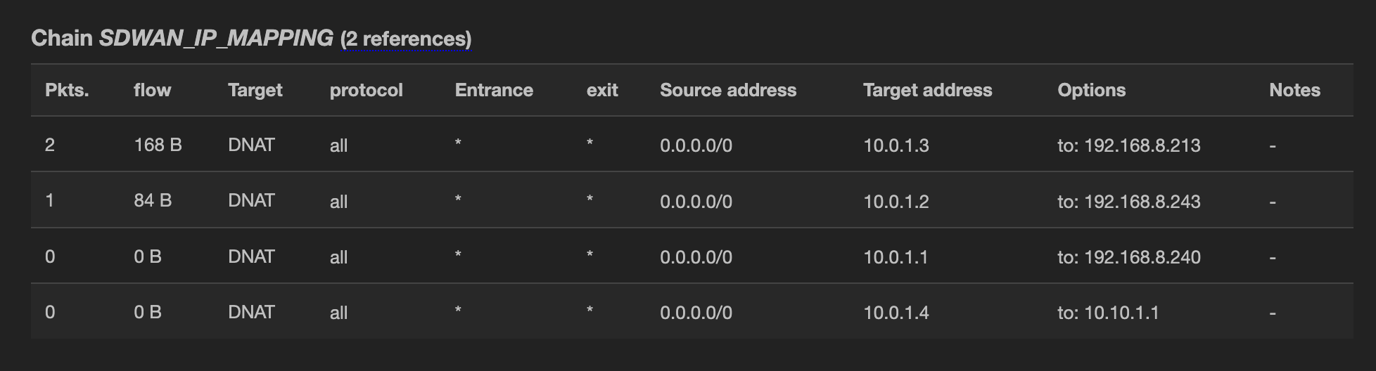

Also, I have found some AstroWarp-related rules in the firewall:

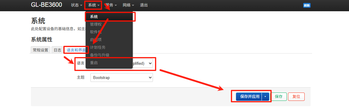

And one more interesting thing… all the LuCI is in Japanese, and there is no way to change the language… :thinking: very difficult…
It appears the DNAT firewall rules have been added correctly.
Would it be possible to provide the results of a packet capture?
Please note that we need to access the device using the IP address assigned by AstroWarp, such as 10.0.1.1 as shown in your screenshot, rather than the internal network address 192.168.8.x.
Thank you for your report. We have acknowledged this issue and will address it in a future release.
For now, you can manually switch to English using the following method.

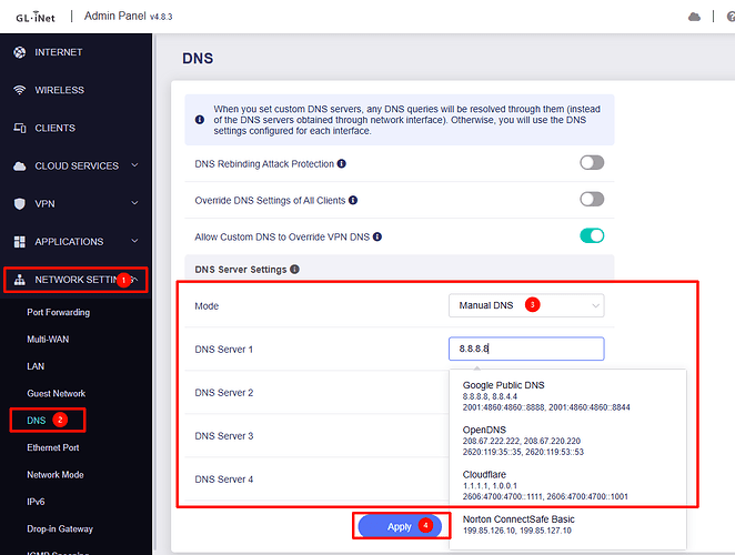

It appears to be a DNS-related issue.
Please go to Admin Panel > Network > DNS and manually configure DNS to Google or Cloudflare to see if that resolves the problem.

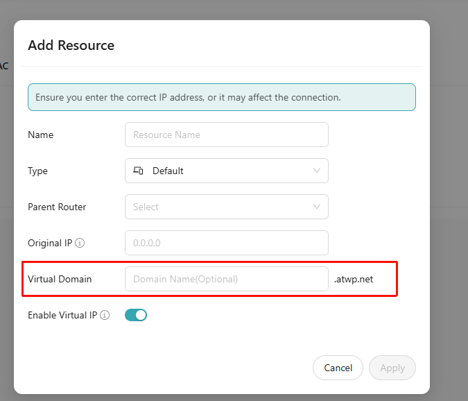

Just FYI, this instruction conflicts with the AstroWarp documentation which says not to use 1.1.1.1 due to being encrypted. FAQ - AstroWarp Docs
It took you three months to add that?
There may be some misunderstanding here.
This FAQ applies to DNS resolution issues encountered when accessing resources via a virtual domain, where the DNS configuration should be adjusted on the device like PC or phone rather than on the router.
The resource domain name is resolved locally by the router. Please make sure that DNS encryption is not enabled on the device side and the DNS server is not pointed to an encrypted address such as 1.1.1.1.
It is not related to the issue the OP is experiencing with being unable to access any website through the internet exit node router.

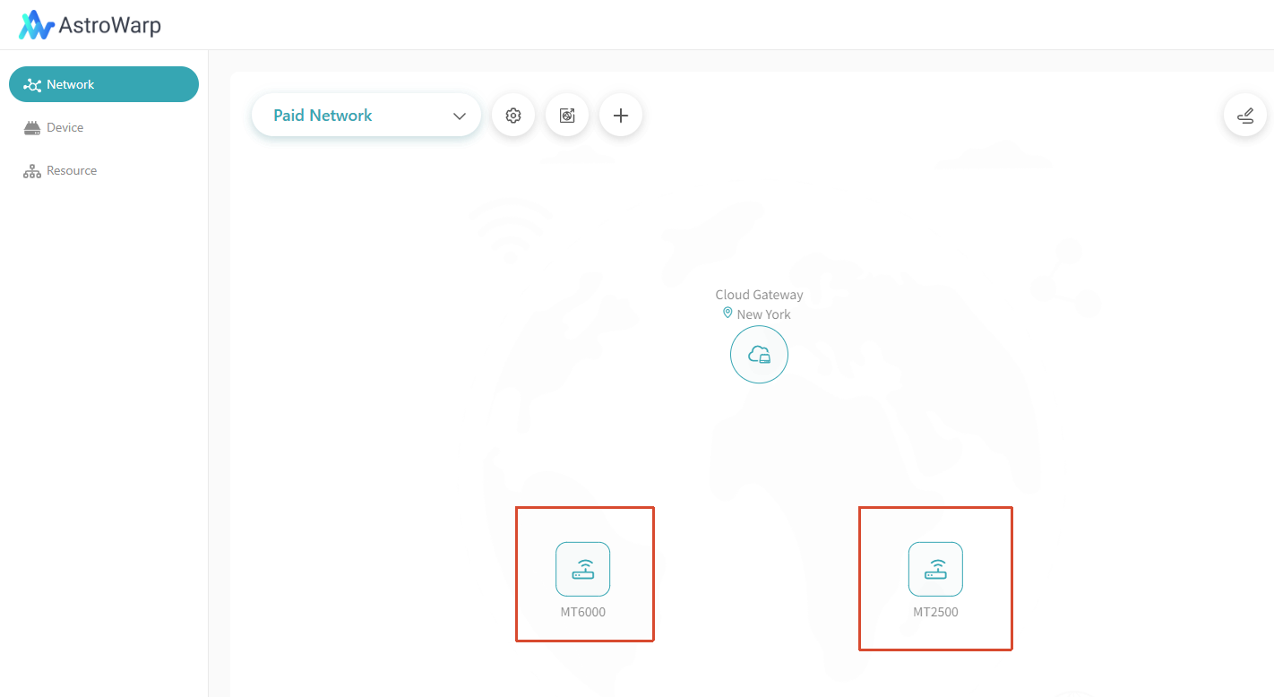

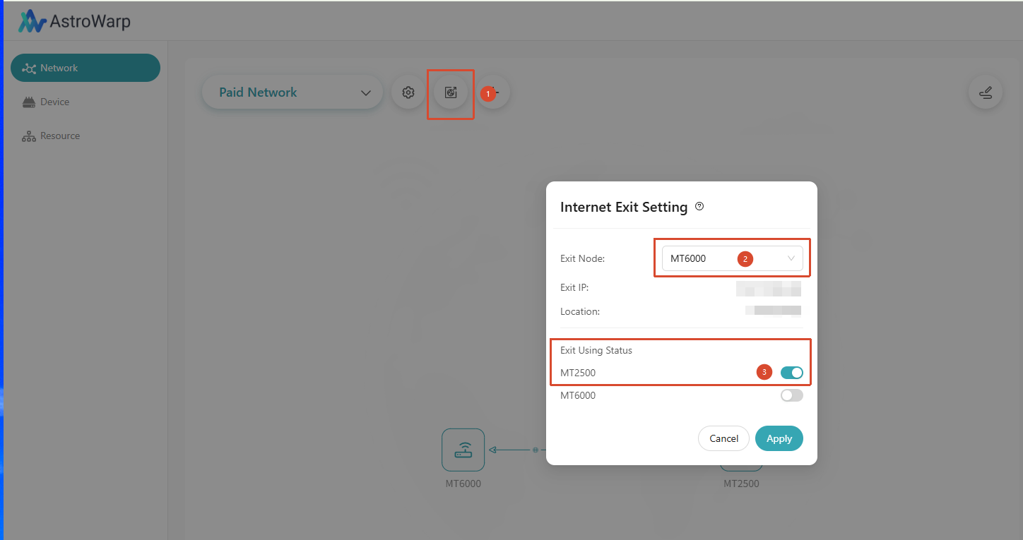

Similar issue. I have a GL.iNet Flint 2 set as the exit point in AstroWarp. I need to connect GL.iNet Brume 2 as a client, for use when travelling, and the Brume 2 is already travelling (not on the same premises as the Flint 2, so can’t connect to the same network in the first instance). The instructions are only ‘add the travel router to the network and configure it to use the home router as its internet exit’. How do I do this?
Please refer to the following documentation:
In short, you only need to:
  1. Configure the travel router in the same way and connect it to AstroWarp as well.
  2. Assign it to the same AstroWarp network as your home router.
  3. Set the home router as the exit node for the travel router.
