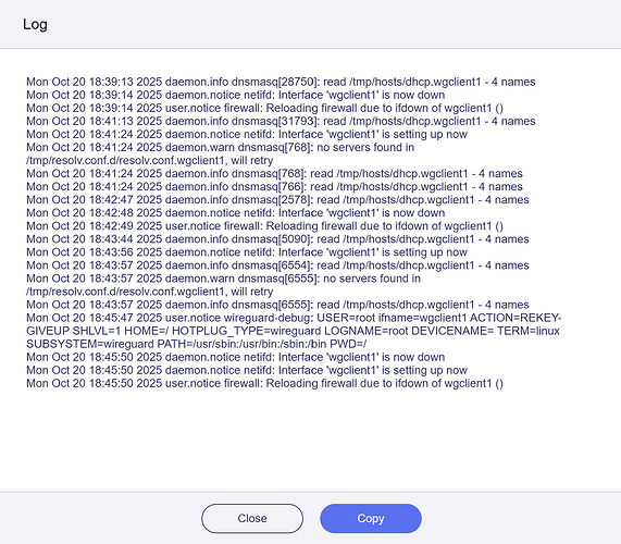

Cant connect to wireguard server anymore? reloading firewall due to ifdown
Hi i tried to connect to my home glinet server but my glinet client keeps saying ifdown(). i read some posts before and turned of cascade vpn off by only using global option but still not working. Any idea how to fix that?
It sounds like your WireGuard (WG) VPN was working well previously but has recently stopped, is that right?
To help us troubleshoot, please check the following points on the VPN server side:
  1. Confirm your ISP is still providing a public IP address.
  2. Verify if the public IP address has changed, or if your DDNS is resolving to the correct, current IP.
  3. Check that your port forwarding rules are still active and configured correctly on your router.
  4. Try changing to a different UDP port for your WireGuard connection and testing the VPN again
